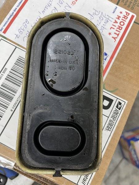

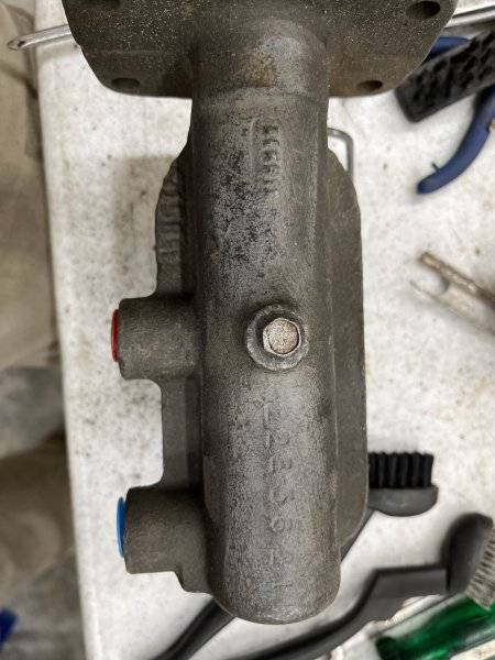

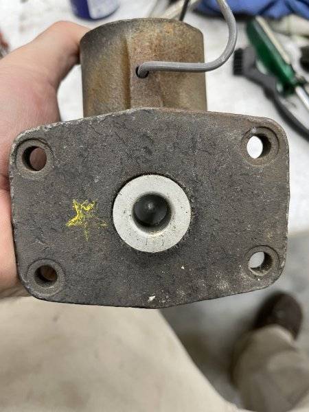

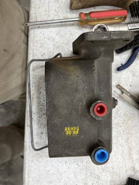

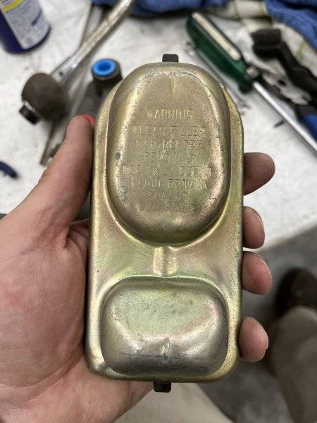

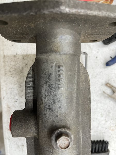

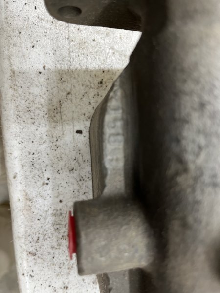

Any help on ID for this. Stamped in yellow on Side reman. 2223621 on bottom. 158 on flange near red cap. Thanks FBBO.
This is off my Dart, front disc brakes. Bore is approximately 1.080.
That is a 67-70 OEM disc brakes master cylinder used on a variety of B and C bodies. The cap is aftermarket though.
67 all B body with disc. 68-69 hemi B body disc. 70, and iirc 69 too C body disc.
Casting number is 2225621.
