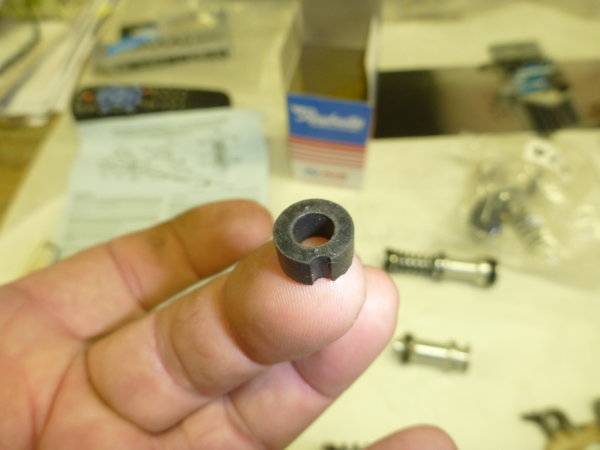

This little bugger??? Comes in the rebuild kit from Raybestos.
I know Mancini has them with their push rod kits, not sure if you can buy it separately.
