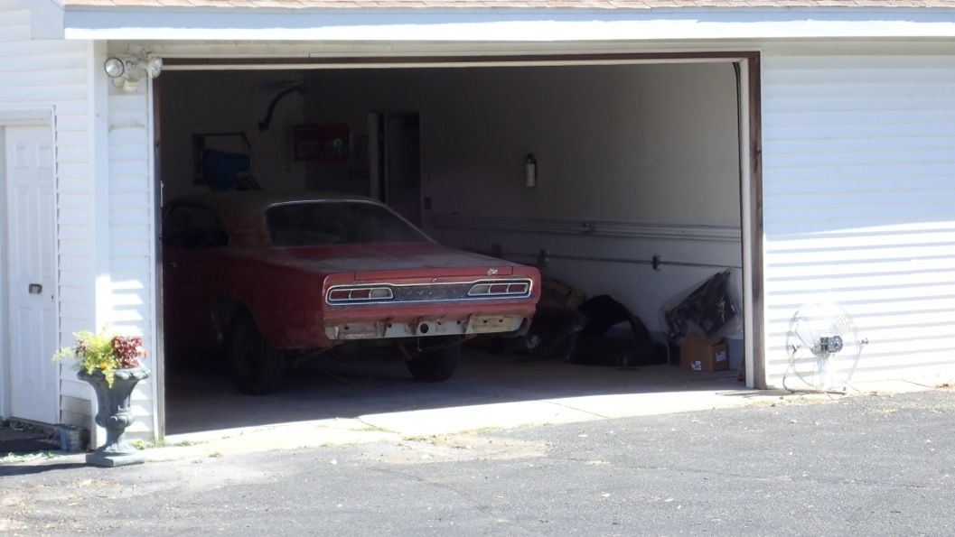

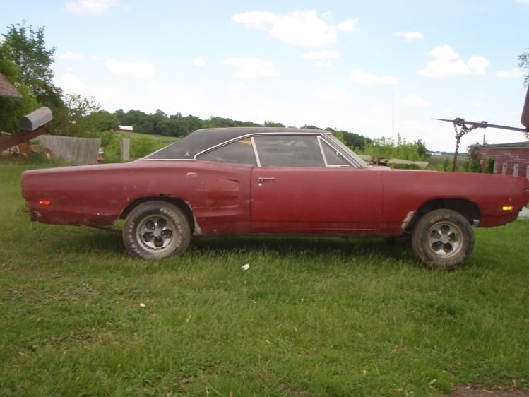

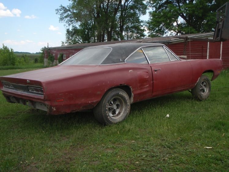

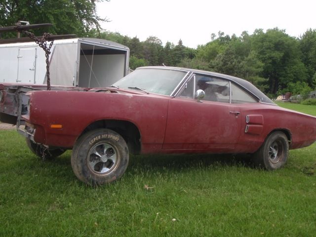

1969 Super Bee 383 AT PS
Minnesota car with almost all the original parts it came with and a helluva lotta rust along the way.
Got new quarters, deck filler, front splash shield, both front inner fenders, lower rear window corner patches, rear trunk floor/ extensions and outer wheel housings.
Car came with a refurbished fuel tank and new rear frame rails / crossmember installed, nicely done too.
Replacing the rusty, rotted and mudded RF fender with a clean southern piece that's on it's way. Metal patches on the LF fender and lower windshield corners.

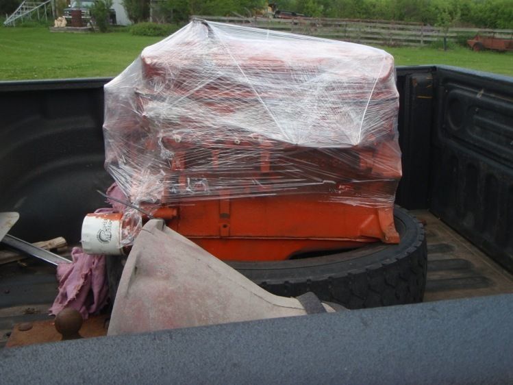

Rebuilt 383…we'll see.
Gonna pull the pan and see if any bugs got in and check the bores. If it looks good, off to dyne to see if it runs.

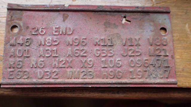

Car will be re-built pretty much as Momma Mopar sent it out of St Louis back in '69.
R6 red, black bench seats/interior and vinyl top, rally dash w/tic-toc tach, 383 auto, stripe delete, ramcharger hood, 3:91 sure-grip....some other little stuff.

Like the vintage SUPER JET SPORT tires.

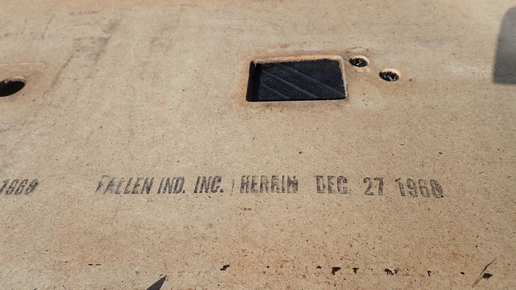

For the detail freaks...here's a January built car with the round filler neck hole.
When did they transition to the oval? <shrug> Research continues.....

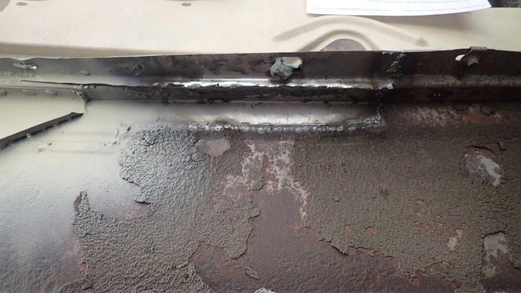

Crusty floor removed and prepped for the new one.

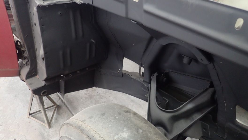

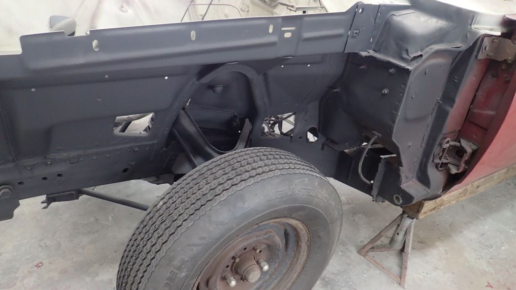

Both front inner fenders done and some minor patching on lower firewall

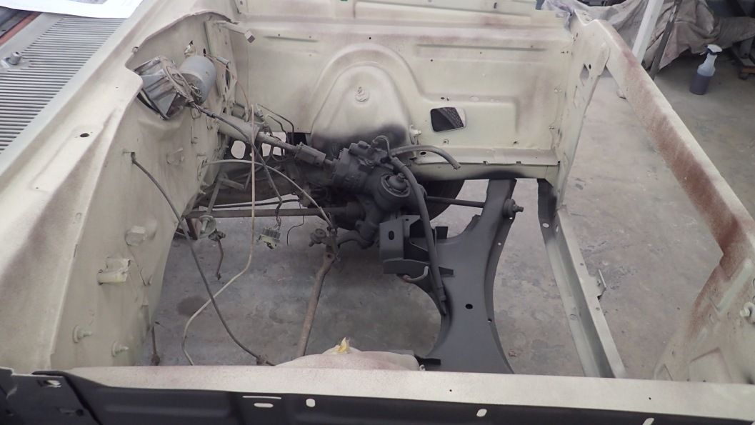

Engine compartment / K-frame and cowl done....also with a couple small patches down low

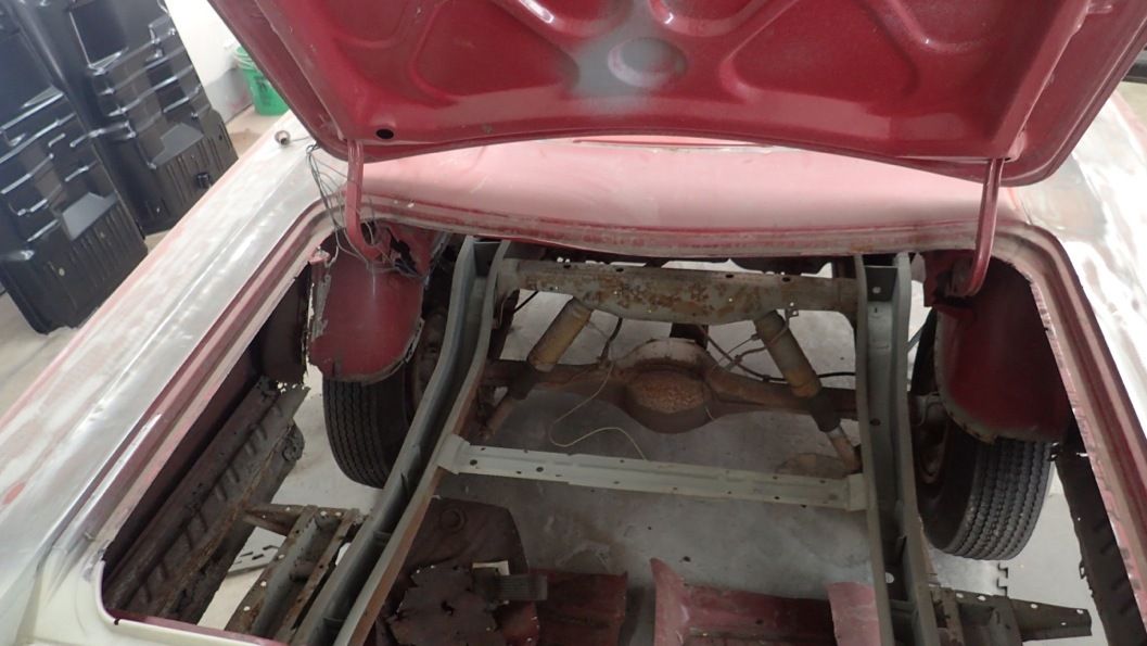

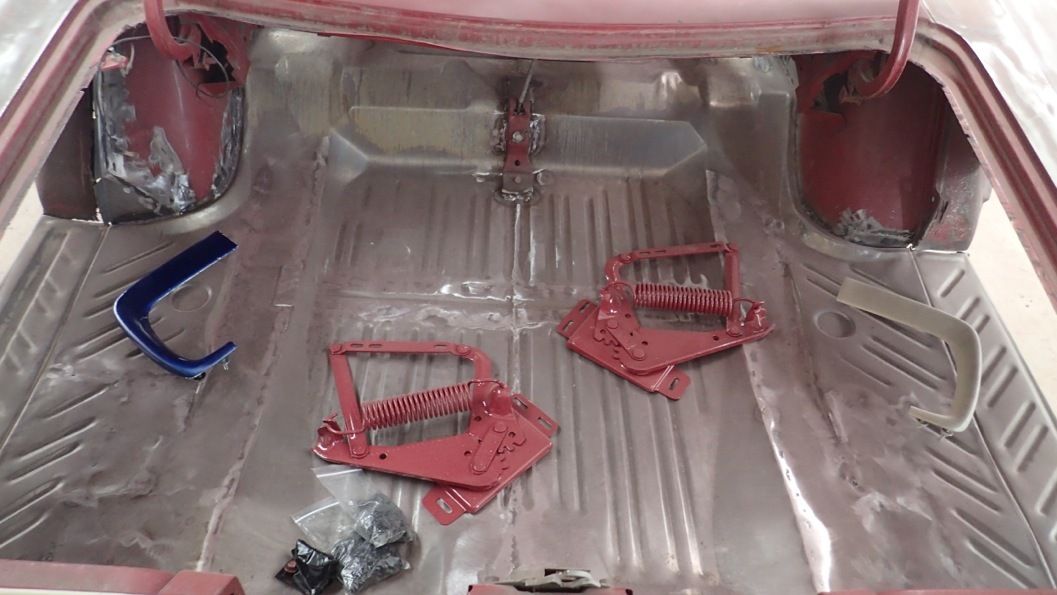

Trunk area ready for new floor

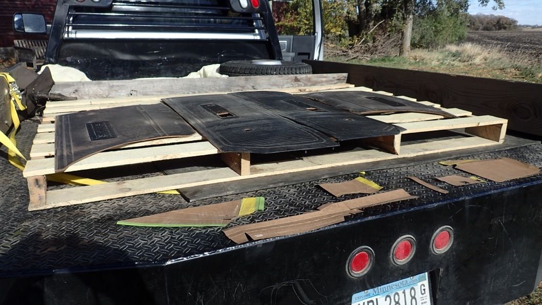

Good door and rear trim panels, cardboard templates are what he used for the bigger stuff.

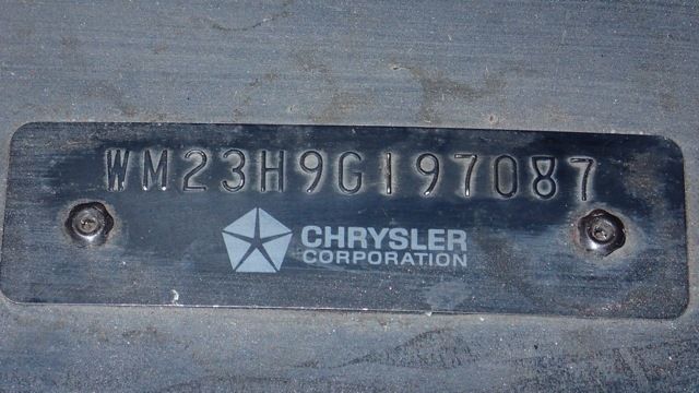

Same # on body, engine and transmission so far
Also still has the "Black Button" door handles, thought those changed to Chrome around Jan 1st. Guess not, at least at the St Louis plant?

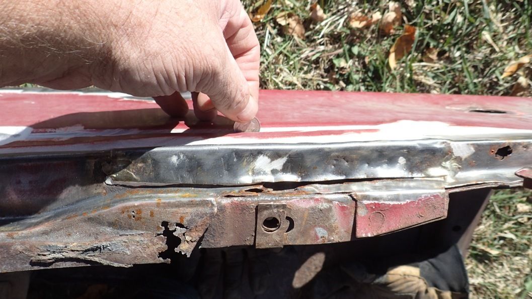

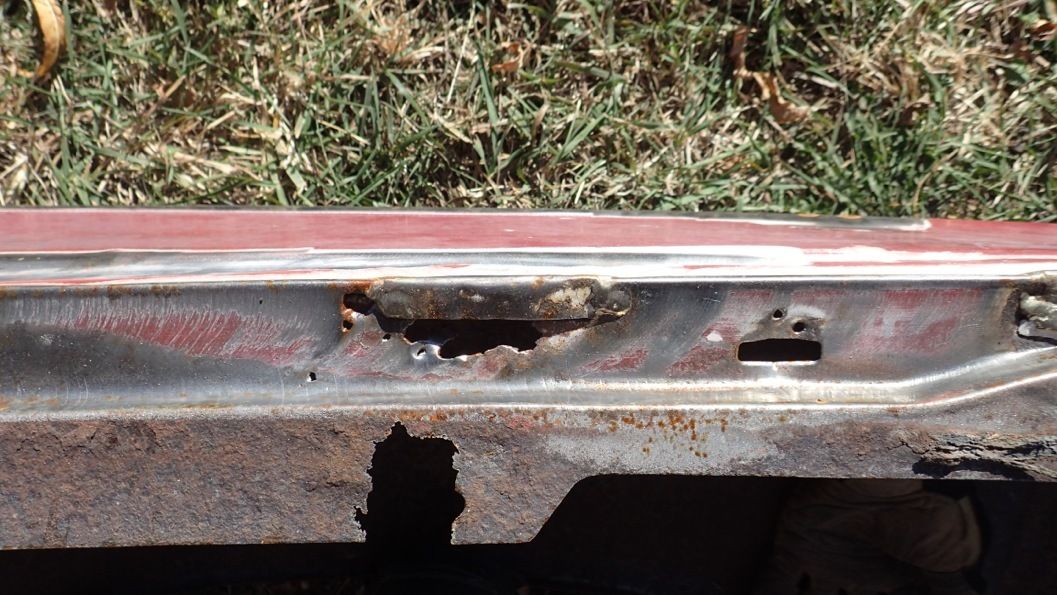

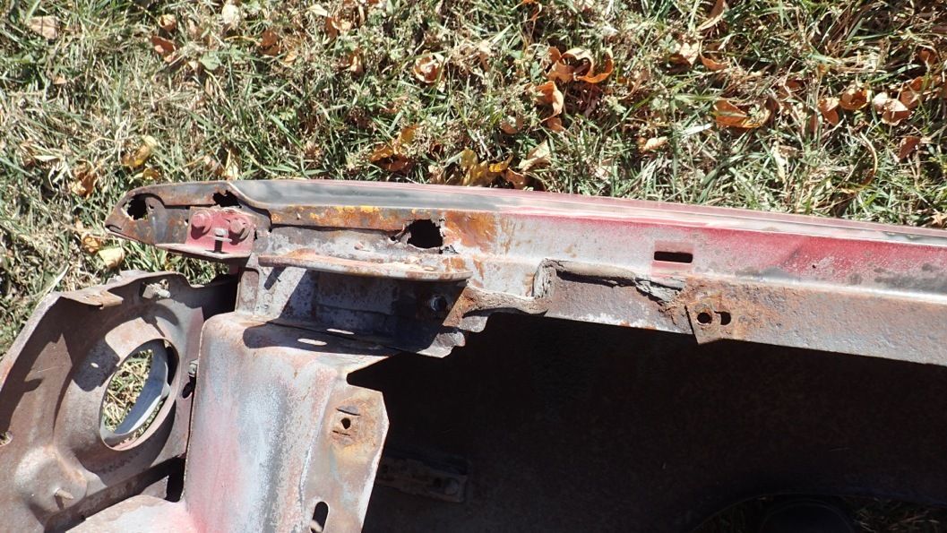

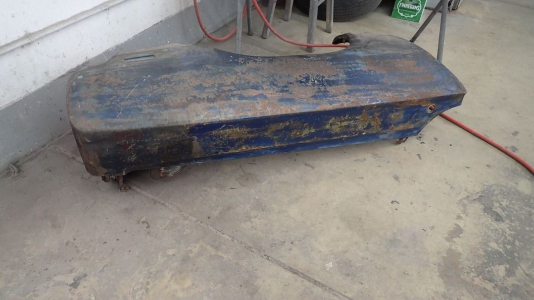

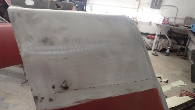

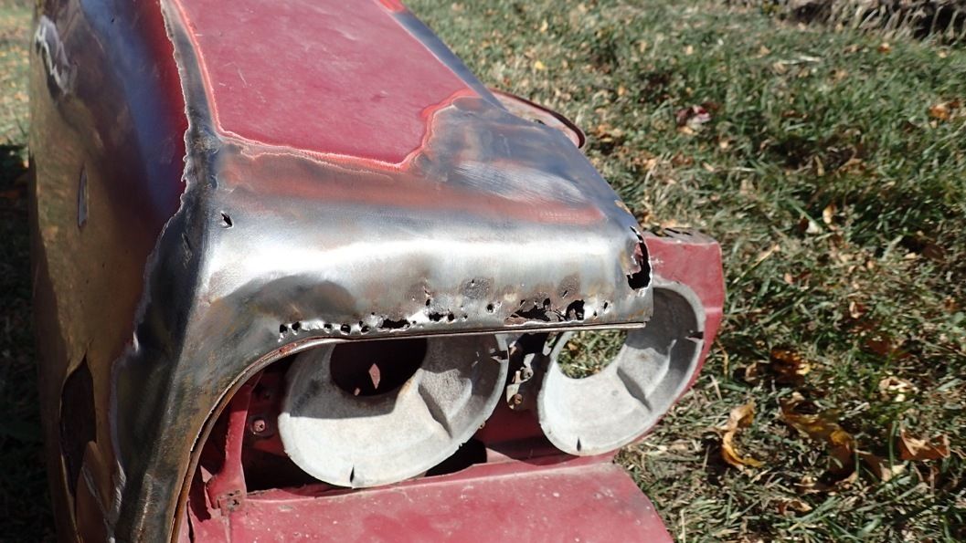

The front fenders……gotta run what ya brung since no repop is available.
RF was beyond saving, hit at least twice, rust and bondo was everywhere.
Previous repair was a gas weld braze, perpetrator got a little ham fisted with the hammer / pick and sunk the top of the fender down pretty far.
Bondo to the rescue, it was 1/8+ thick over most of the top.
The replacement fender from down south, something to work with. A couple small soft dents to fix and a few badge holes to weld up. One patch down low.
The LF was still salvageable, a few skin patches and new gussets, good to go.

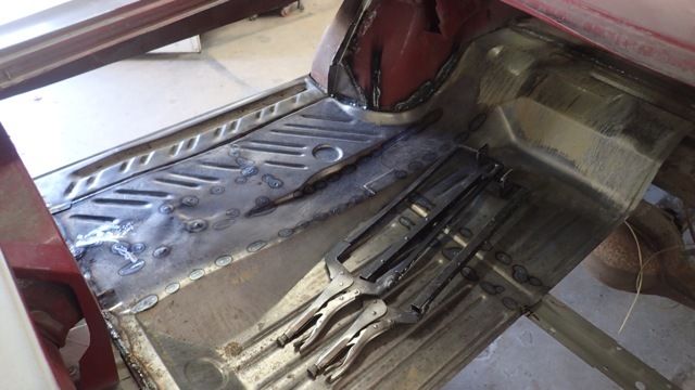

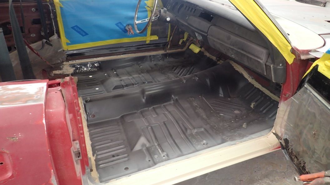

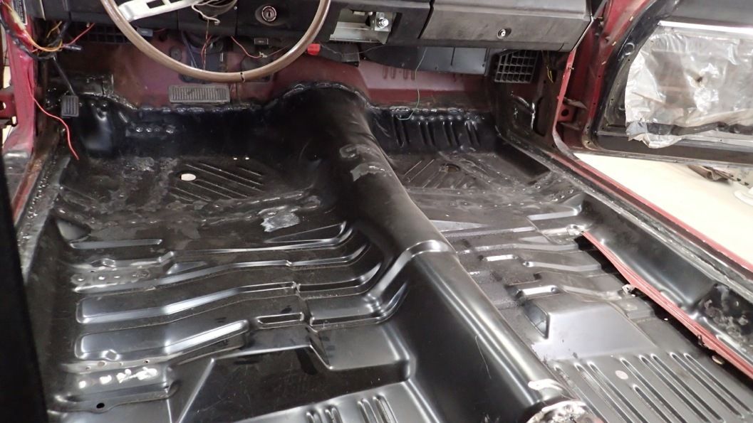

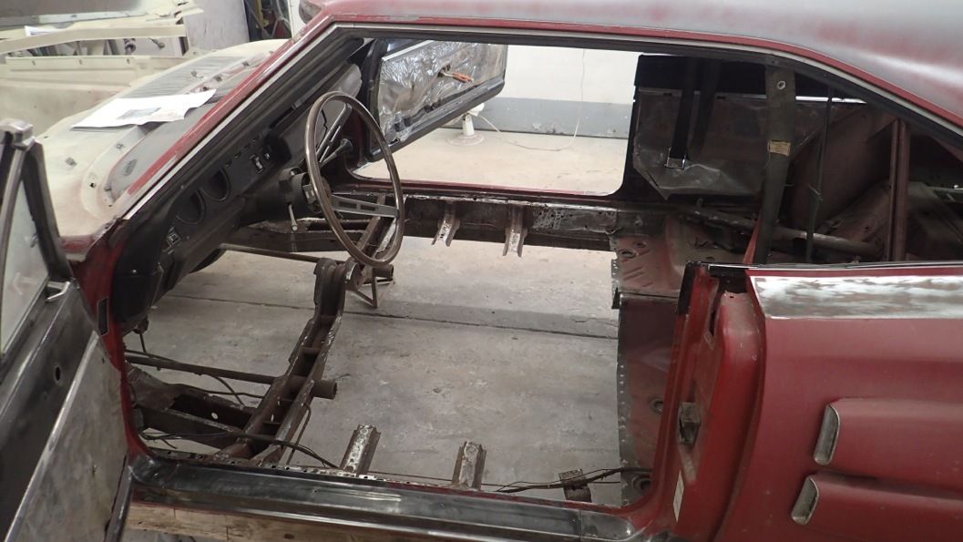

New floor is in.
Trunk floor and extensions are well on their way to completion.

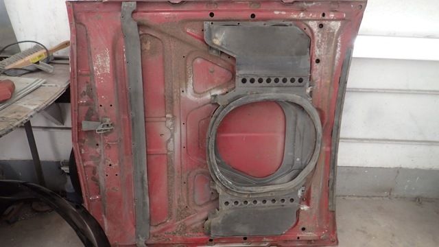

Will be starting the disassembly of fresh air duct work to prep hood for paint.

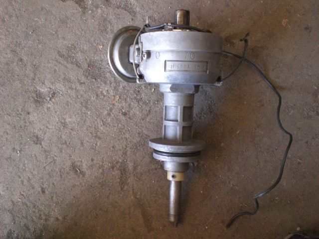

I have a nice numbers and date correct dizzy on it's way…so I got that going for me.

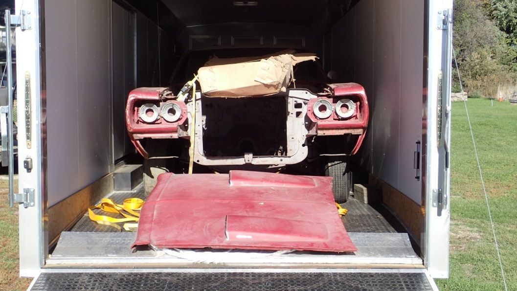

Quarter panels arrived Tuesday, Body Man Bruce is excited to get going on that part.

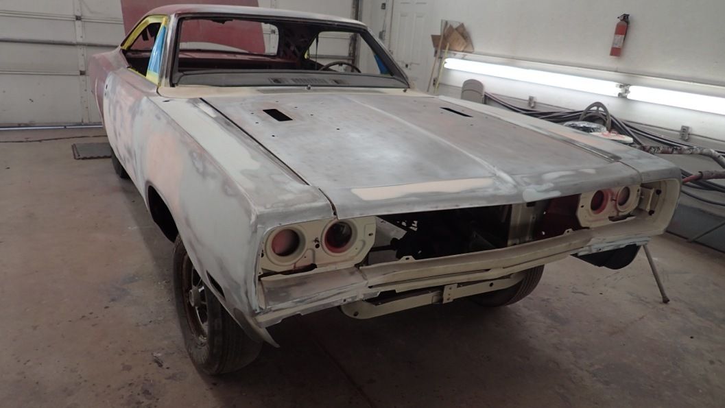

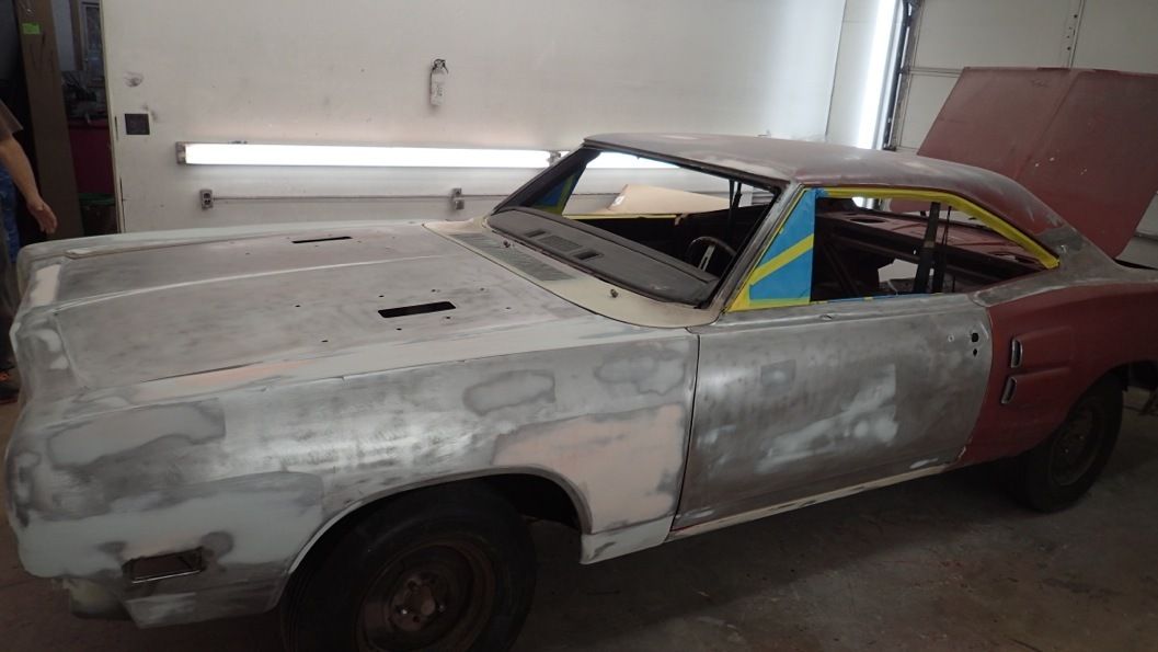

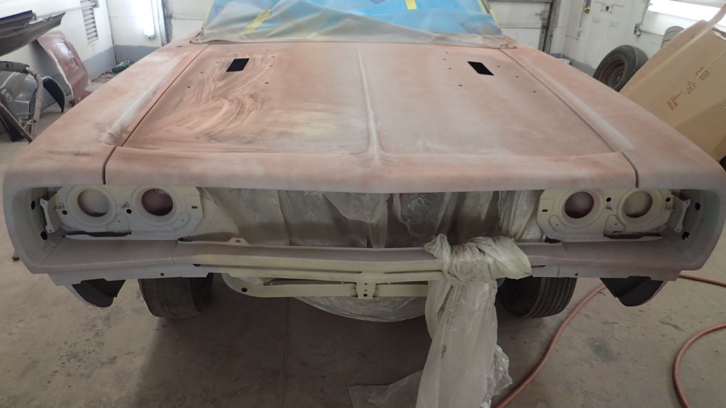

Front end is getting smoothed out and lined up. Gaps are awesome for a Mopar, doors close sweet too. Hood is just sitting there.
Interior is getting ready for paint and trunk has a few more improvements as well. Painted the hood hinges, first splash of new color in a primer world.

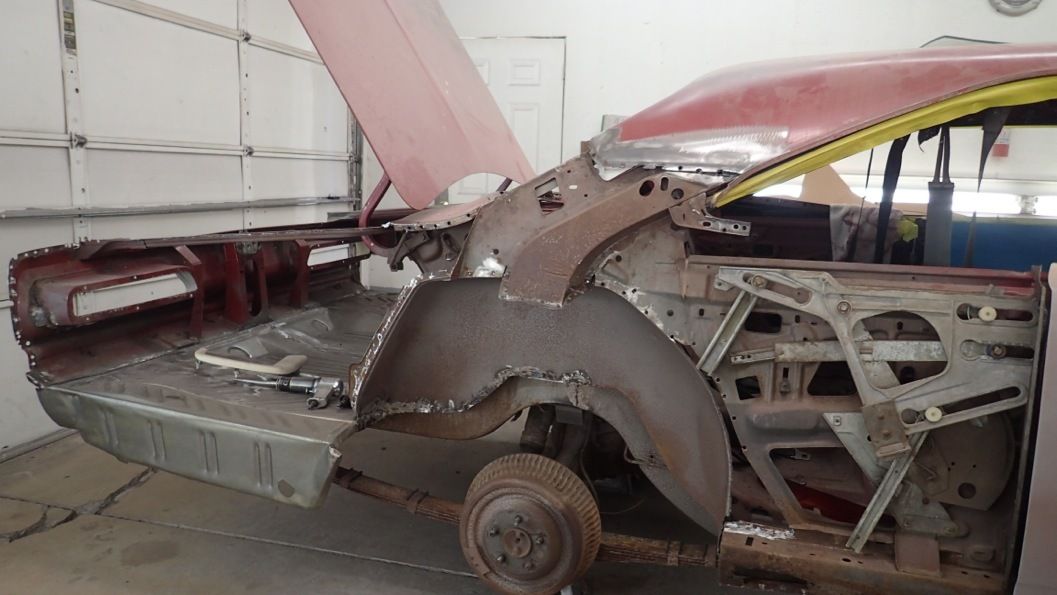

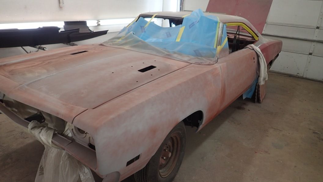

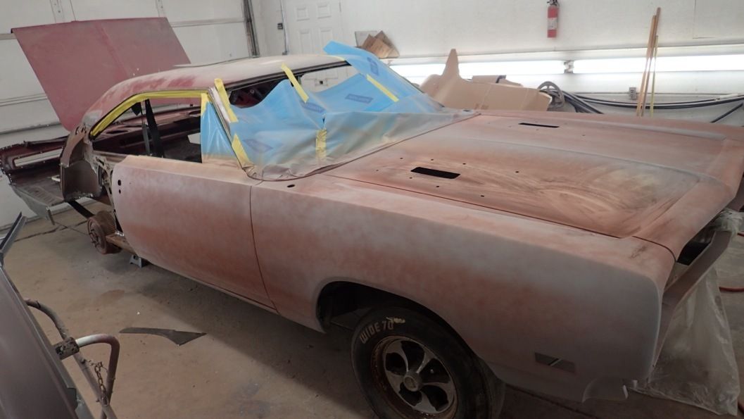

OK, about a month into it and I think looking good.
Fenders, roof, doors and hood ready for blocking.

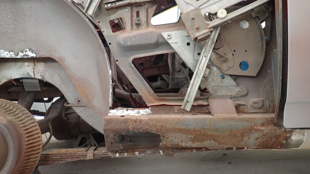

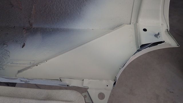

Old crusty passenger quarter skin removed and patches made for the hole in rear of the rocker and area where inner wheel house meets rear window framework.
Body Man Bruce made two sets of patches for these holes since the other side is in the same condition.
Next, on to the deck filler and then the other quarter.
