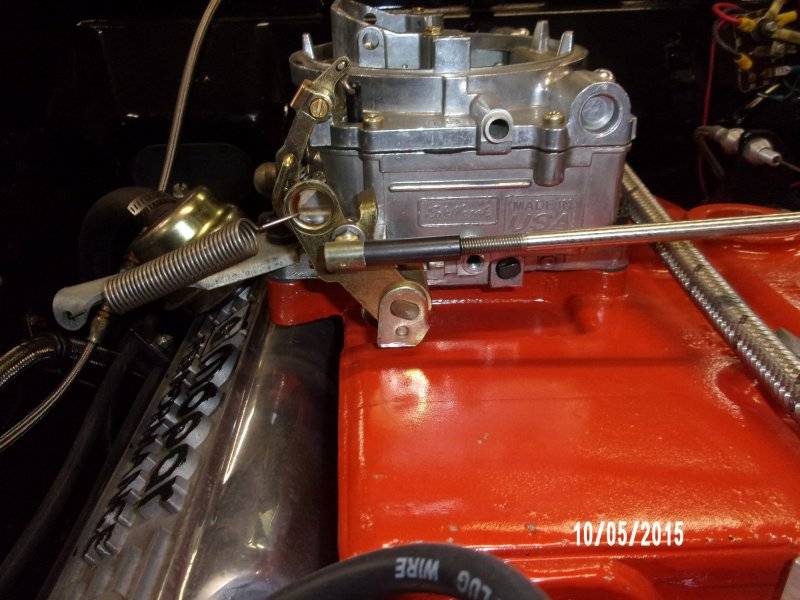

Id I wanted to swap my original 3705 max wedge carbs for a set edelbrock carbs will the current linkage work on those carbs or is there something I would need
I used Edelbrocks on my maxie and had to cut the bottom portion of linkage off to clear the intake surface.
