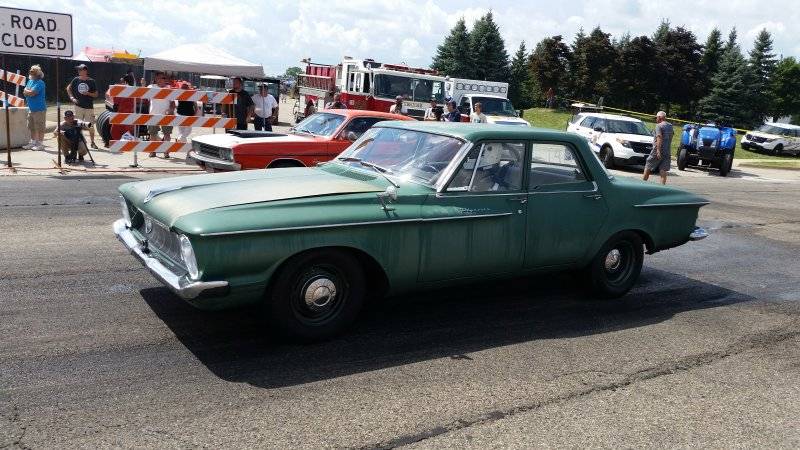

People have glued the early caps to late caps. Then they'll snap on to late wheels. We drilled the caps and used 3 small head machine screws into the rims for years on this 62. Had to look really close to find them.
