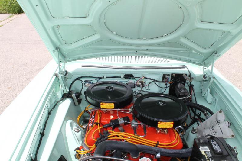

273.jpg This is my '62 sedan. The bracing is not cut an there is clearance. I do have a torque strap to limit engine movement. It's close but there is room. At least there is on my car.
