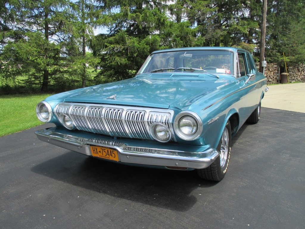

Nice looking car.

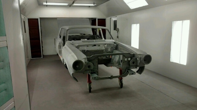

The PB is referring to the Push Button Transmission, which I have picked up a '65 cable shifted 727, with a spline shaft output, and will need to fab the driveshaft. I didn't think the power brake system would fit, but I do plan on trying to get a 2-bowl master cylinder in place of the single. Thanks to all who have been contributing, and I am taking notes on this, to avoid mistakes along the way. Just an update, here is the car as it is today. Came back from media blast, and will be repairing all issues in the body, original AA color code, planned, along with original A code interior. Trying for Carlisle this year, but that will be a long shot, at best...
