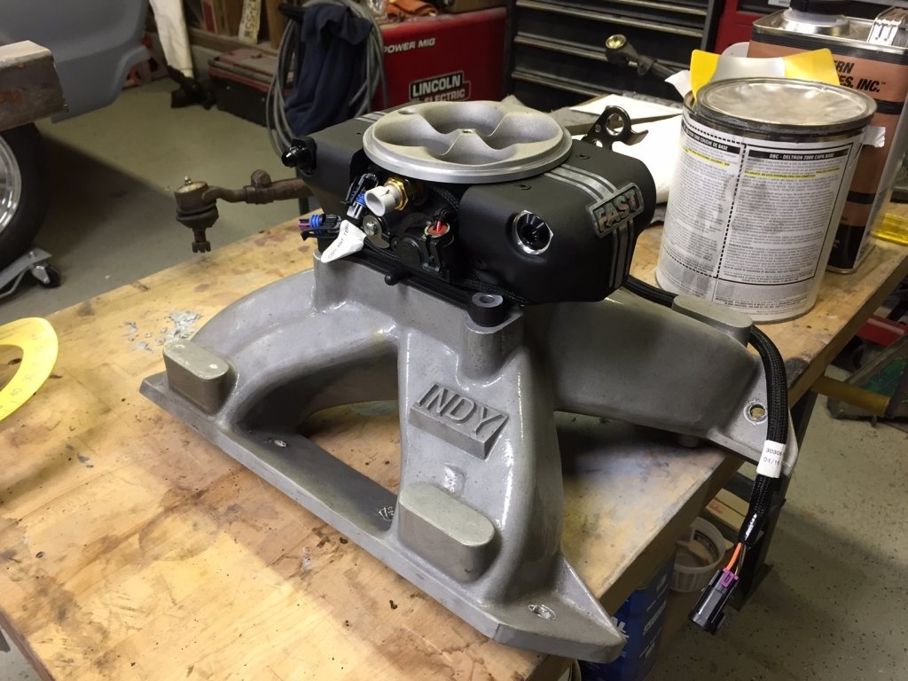

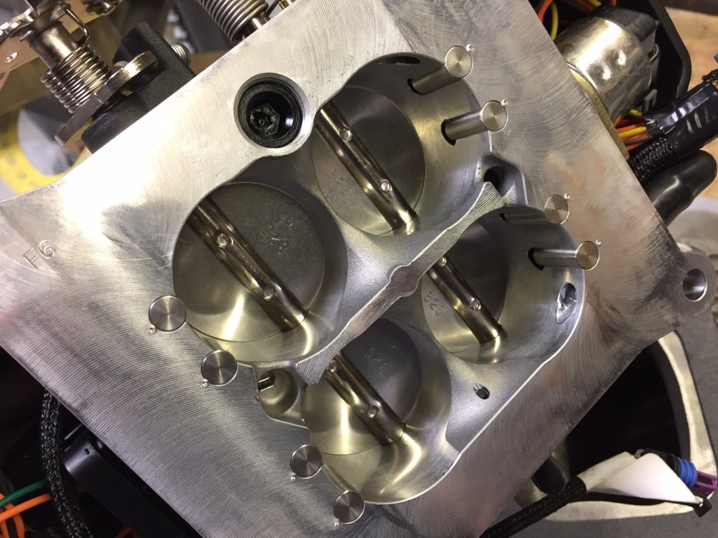

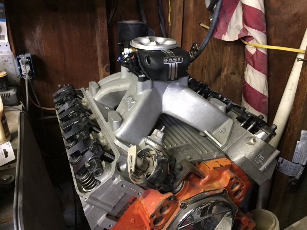

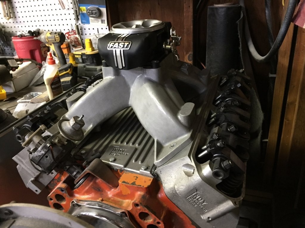

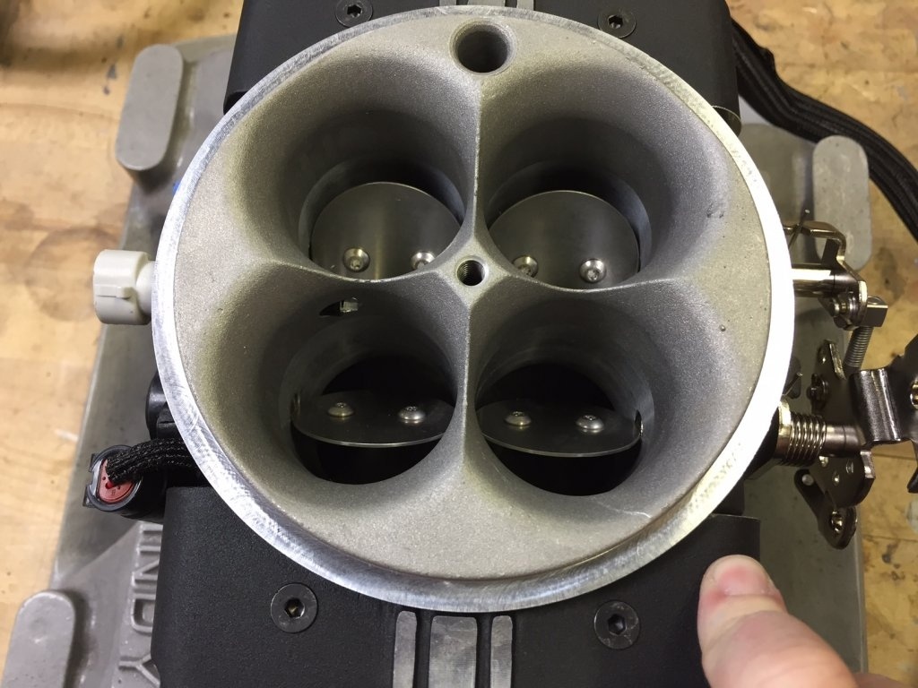

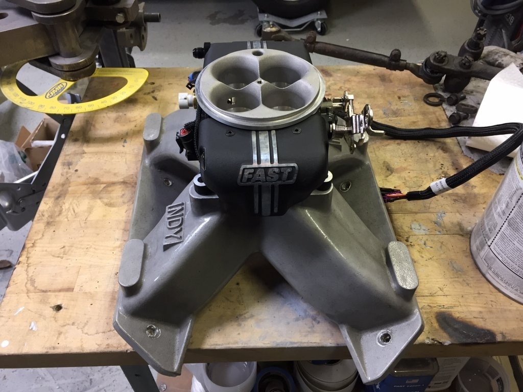

Great topic and one I'll be watching. While I can't offer any seat of the paints experience as of yet, I will be running Max wedge Indy -1 Heads with a Comp .278/.281 @.50 (.681/.660 lift) roller, 11:1, 440, On the street. I was also debating the 4150 vs 4500 Carb set up and talked to a lot of different people about it. Comp, Indy, Hughes, AED, F.A.S.T, Dynamic, Etc.. and what I found out was in order to run a head with 350-380 cc intake runners it takes a lot of cam to feed it. Reducing cam size much below what I currently run will make a very wild street motor still wild but be very piggish with very poor throttle response and performance. This was brought about by my questioning of my cam Choice (Bought it used) and wanting to make it behave a bit better (on the street) without losing to much performance. Comp directed me to talk with F.A.S.T about the possibility of fuel injection as it would make for much better street manners and a much more tune-able idle circuit. The way it was told to me was a motor like mine will have very little vacuum signal at idle and would require a very fat idle circuit @ 1300 rpm to run. Fuel injection can be dialed back and forced to spray at set AF ratios not dependent on a vacuum signal. So I ended up with the FAST XFI Sportsman system good for 1200hp and traded my Indy 4500 flange Manifold for a Indy 4150 to accept the throttle body. If and when I get this thing running I'll let you know how it does around town.
Info below:
http://www.fuelairspark.com/fas/xfi-sportsmantm-throttle-body-engine-control-systemhtml/
IMG_1416.JPG IMG_1418.JPG IMG_1419.JPG IMG_1420.JPG IMG_1421.JPG IMG_1422.JPG

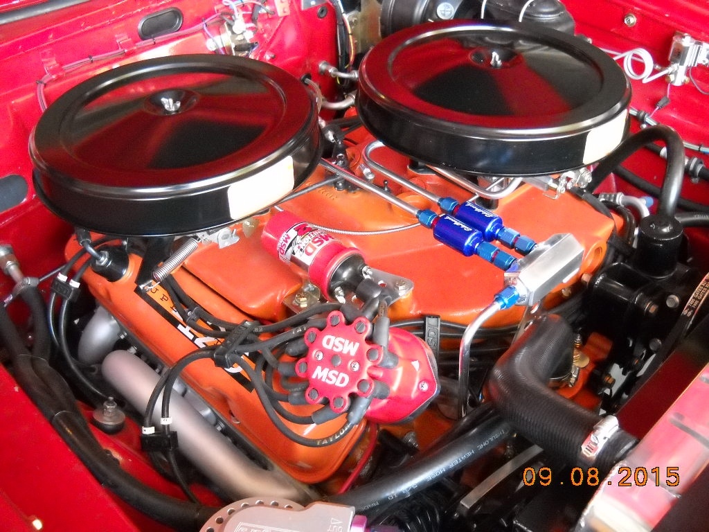

ive got a 62 dart with a 500 with eddy victor max heads and old school exhaust and x-ram with 2 matched 600 holleys from rick walker high stall conv 4-31 gears in the rear with cheater slocks other than the spacers on the heads making the carbs sit up higher making me use a scoop its a kick in the pants and sounds bad *** had to down play the cam to a schneider 550 solid as to get better idle but I cant wait to put it on the track
