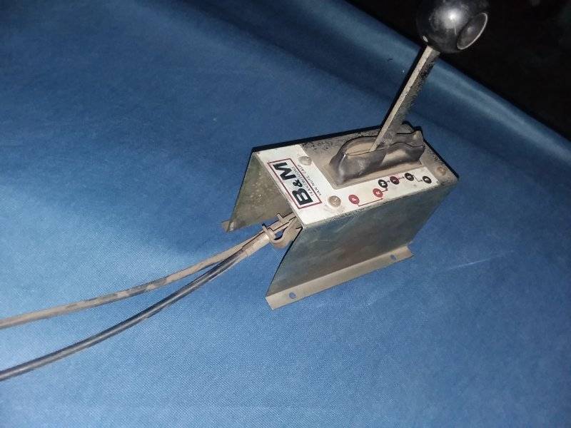

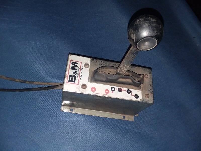

Maybe you need to find one of these. B&M for a pushbutton trans. Lol.
