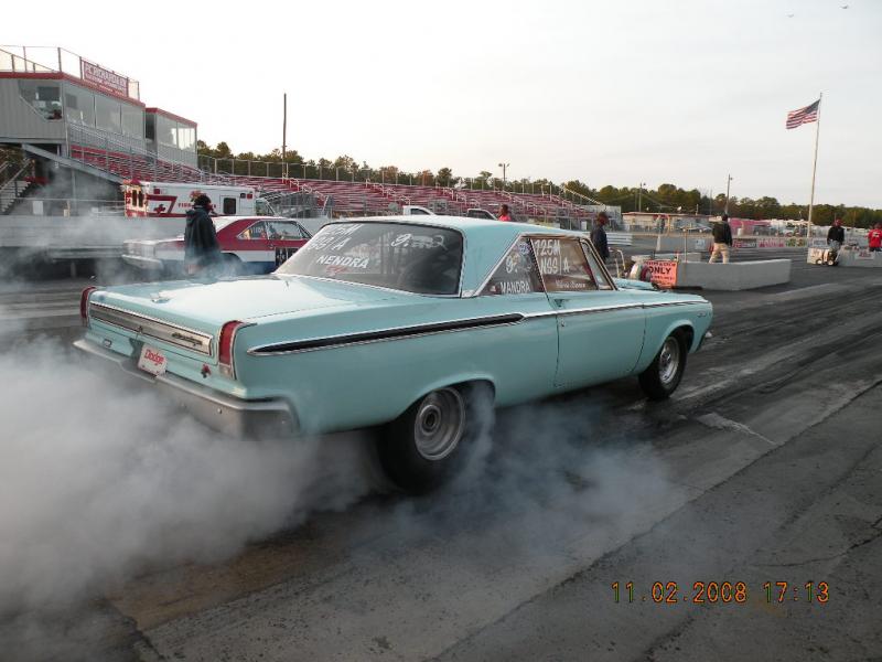

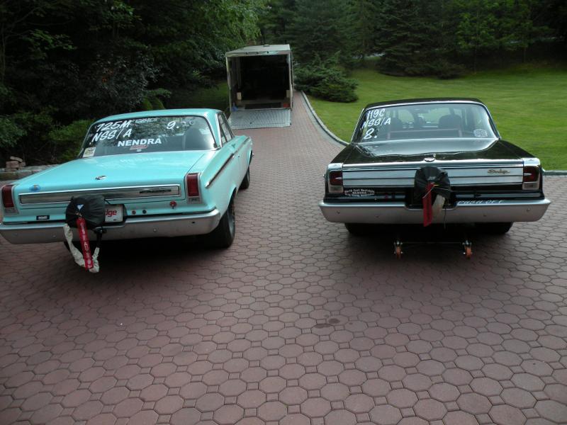

That is true. Most or all do allow 65's to race with a wedge in them instead of a hemi in NSS organizations.
65 dodges and plymouth's are very popular in NSS racing
