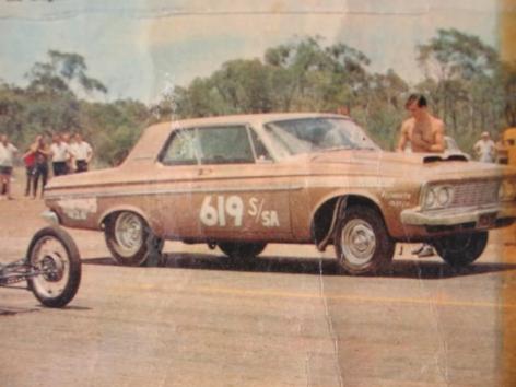

This your car??
Yes mate, that is it in Dec 1964 Riverside drags Australia.
PM you email to me and could send you pics and measurements ?
Original scoop is bolted to a 2"+ riser but unchanged apart from that.

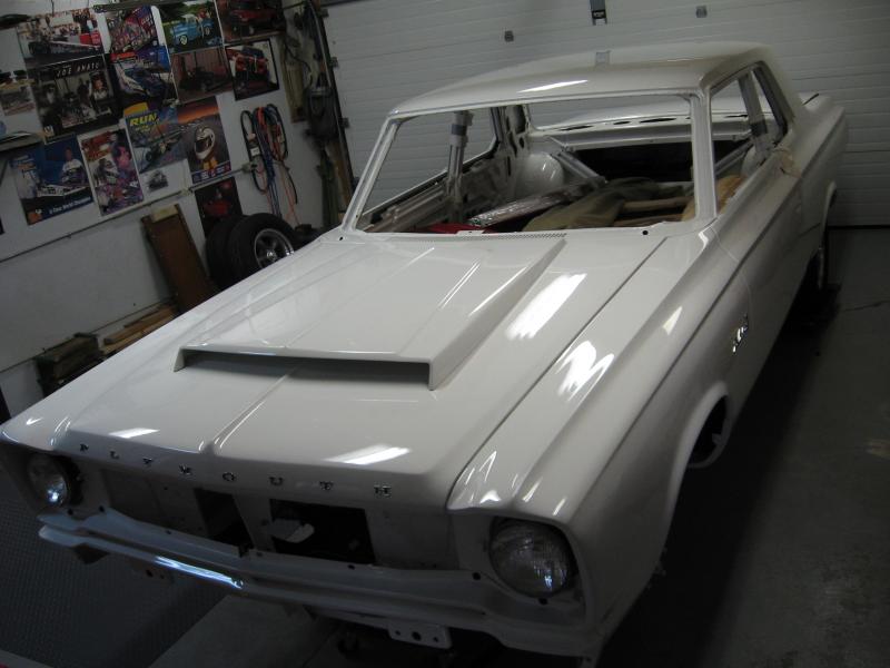

Dont know if this will help you but I looked at many scoops before I put this one on my 63 just where it looked like it should be going by all the cars I looked at. Ron
