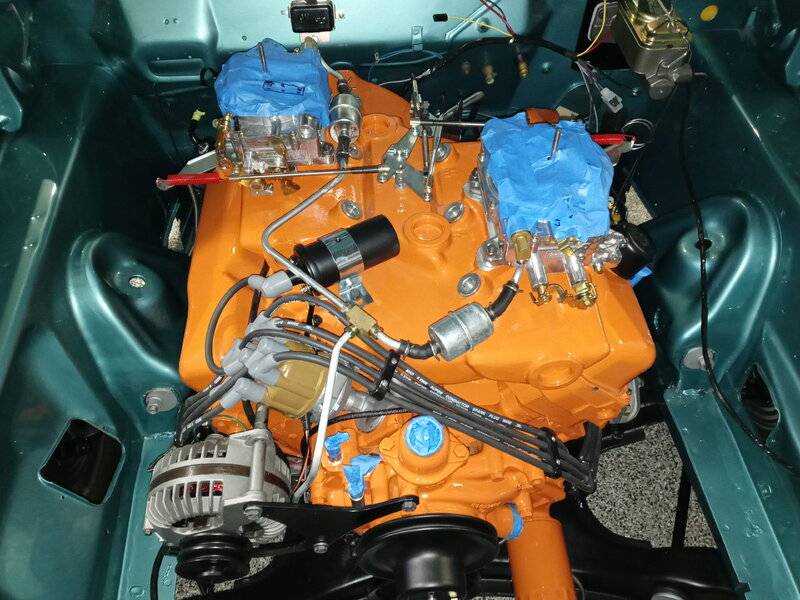

Recently discovered that A&A Transmission sells a MW type cross ram for a 440 and also has MW style exhaust manifolds available. Thinking about trying to create a "tribute" Max Wedge motor out of my Magnum clone motor. It has 452 heads, purple shaft 284/484 cam, approx 9.3/1 compression. It has a 727 pushbutton, stock converter, 3.54 Dana.
Anybody running something like this?
Thoughts? Cool? Crazy?

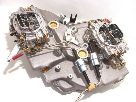

I'm not sure, but Rick over at A&A, may have a MW intake, for the smaller ports ? I'm using his set up, on my 440, but with new MW heads...
A&A has two versions of the max intake, one is max size, the other standard 440 size.
I like the idea, but im sure you realize, it wont be cheap! My guess, for intake, carbs, throttle linkages, air cleaners, exhaust manifolds, and exhaust system.... $2500? More?

It's cool for sure..... but you'd never see me spending money like that on "clone" when you could do "REAL" for the same money. 452 heads would not be my first choice on any build but a restoration project. Just my two cents for sure, but I'd do it all max wedge for sure, and strong chance those parts will hold their value for you much longer than the other (clone) way.

While there is no doubt that the max intake is awesome to look at, i dont think i would expect a huge performance bump from it.
I changed out a tm-7 tarantula that had been welded up to work with the maxwedge heads on my 440 bracket car, (850 dp) for an original maxwedge intake with two 750 competition carters. After tuning the carters the performance improvement was......nothing.
Doug ( DVW) tested an original intake against an indy "crossram" (chuckle!), on his engine, and the indy was almost a hundred horspower better.
Nothing looks as Badass as a cross ram Maxie! If you have the $$$ and the desire, just do it. For a street car, the 452's and the small port cross ram should be O.K. Put a couple of 500 CFM carbs on it instead of original Maxie 750's. You will likely only be running 9.5 compression on a street motor instead of 12.0.
Yes they do sell one with the stock 440 intake ports. Occasionally they come up for sale used but they sell fast. Yes, it's more for show than anything but it's still a dual quad cross ram and I've been told they run pretty decent on a typical big block. You should be able to find a pair of good used 450-500 cfm carbs cheap and can use 225 slant six air cleaner lids with cheapie drop bases. The intake plugs are the same as a 7-1/4 rear axle plug.
mancini racing has them for 440 for 3195 dollars as shown
