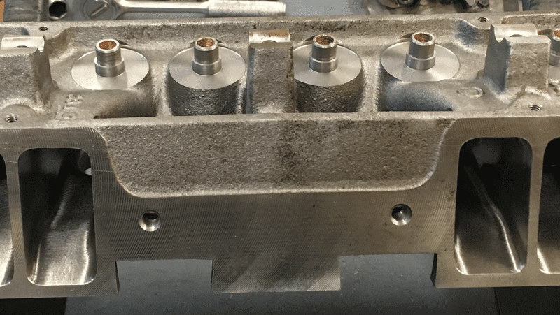

These are max wedge mopar reproduction heads P5007494. Pulled due to oil getting into combustion chambers from somewhere. Head gasket was fine and rings are good (all comp tests passed at least) so I am looking at the seals. Can anyone tell me if these look like correct seals? The umbrella one fits very loose. Supposedly the seals used were Mahle B45403 and 45343. What would I replace these with? The ones I bought that were recommended seem wrong

1) exhaust has an intake umbrella seal on it
2) Intake has an aftermarket positive seal on it
3) 0.060" spring shims on a newer reproduction heads, and they are pretty worn (gold worn to the steel) for 2400 miles

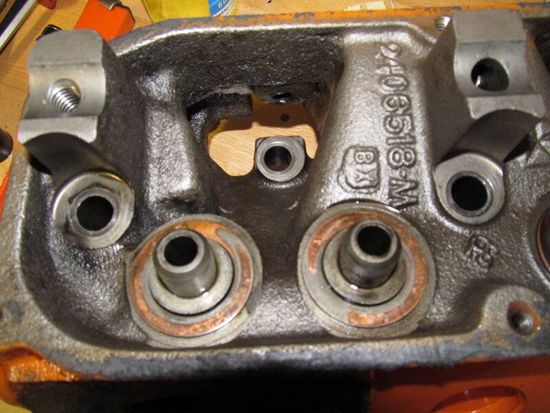

4) Would like to see the guides without valves and seals to see their condition.
From what you said, it sounds like there is too much intake clearance allowing the valve to rock and opening up the seal to allow oil past it.
Yeah I actually think the guy swapped out the motor just before I bought it from the dealer since this is not the motor on the build sheet that was included. Also this is a 413 block bored 60 over with max wedge repo heads on it, shouldn't there be valve reliefs in the block? They are not there. Thanks I will take another pic without the seals.

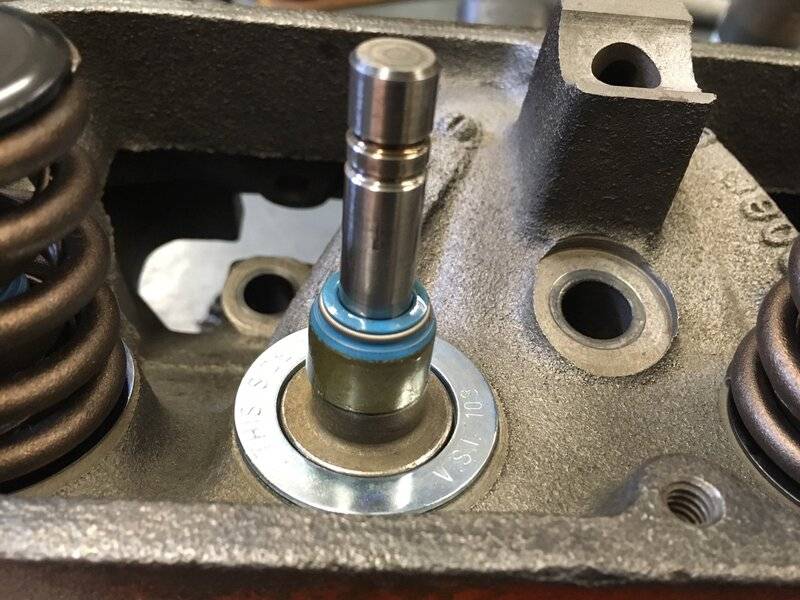

906’s I just put together: 519BD8C4-0F0A-416C-8D5C-B1A4CD553A2C.jpeg

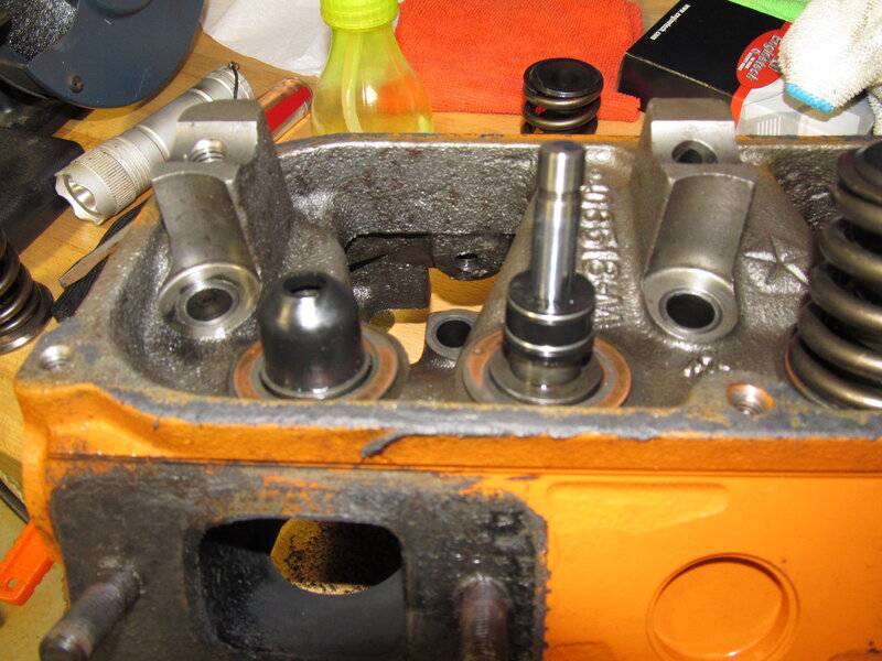

There is no suction on the exh side so the plain jane seal is ok...or no seal at all. Int seal in pic #1 is ok.
I wish you luck. I do not think your smoke problem is due to valves/seals &....never did.
You can see in post #3 how open these heads are around the spring pockets, & the excellent drain off area; the oil cannot pool enough to be drawn into the guides.
