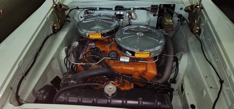

anyone got an idea on a heat shield for the master. dual system master is closer than i like.
Even tho this is a B engine on a 64 Fury the master shield came from Kramer Automotive
My buddy made his own on his 63 similar to the photo posted above. It bolted on using the 2 lower master cylinder nuts.
