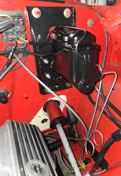

It's a simple changeover on this car. The distribution block is located below the master on the frame rail. Single line from master to block, then there is a line to crossover to right front brake, another line to left front brake and another line to the rear brakes running down driver side. All you have to do is disconnect rear hardline, use a union to connect to new line that will go to master for rear brake port. You can keep the original single to use as the front brakes. And plug the rear line port at the block. So 1 line, 1 union and 1 plug plus the master. BUT I don't want to do any of that would rather buy one pre made. I would think such a simple kit would be out there.
Well Dr Diff just texted me. He has the master and pointed me to the hardline set up. They take a different approach by making a new multi port brass block that comes with the 2 lines going up to the master. I'm assuming my stock front and rear hardlines will connect to this new brass block.

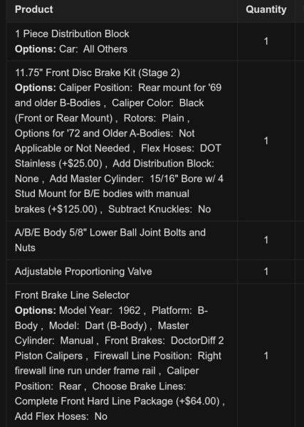

I replaced everything on my 62 Dart with brake parts from Dr Diff.
Master is easily sourced, not sure on the part number, but it's a modern unit.
Brake lines with fittings installed came from Inline Tube, iirc.
He has his own dual aluminum 15/16" bore which is the way I'll probably go. He makes the firewall adaptor for this master and the new lines and brass block is a Inline tube item. I would prefer to keep my single master but I think it may be starting to leak and I'm leery of the replacement ones. My biggest problem is I hate to wrench on anything anymore. Old age.
