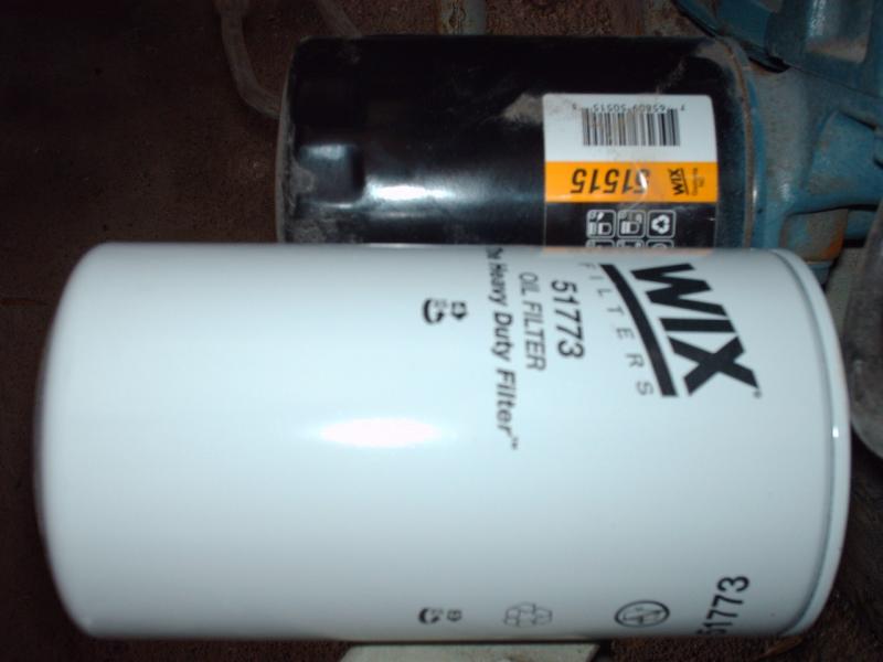

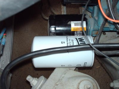

Maybe you want a bigger oil filter for your BB....
racedodge
7:08 AM
Jan 17, 2009
799
205
Eskridge, Kansas
and you do not have power steering (or you do, but it is the type mounted high on the water pump)...
WIX 51773

So all the specs are the same just more filter area?
Great subject. I went to the WIX site and dug up info. It is a direct fit according to the measurements.
The standard BB 51515 filter would hold about half the oil. It has a significantly higher filter rate however, 21 microns. WIX says the 51773 is the two quart capacity version of the 51515.
Does it matter? More oil filtering but at a lower rate in the 51773? Any petro engineers out there?
I use that filter on my race car - the advantage is that more oil is in the filter, lowering the level in the pan = less windage.
