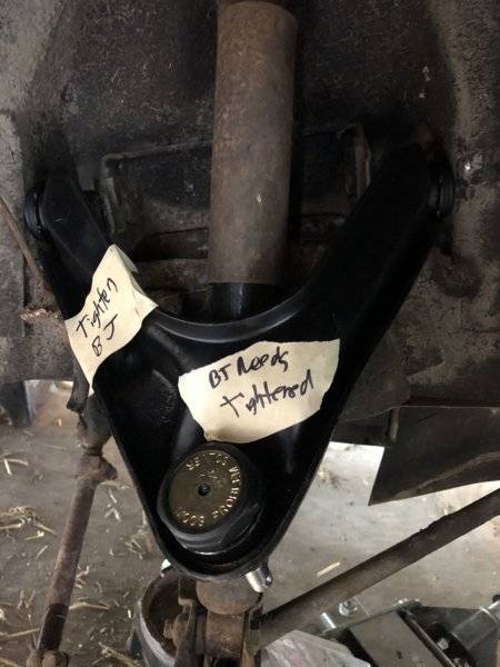

1964 Dodge 440 upper control arms.
Replacing the junk ones with a set of rebuilt ones. Problem is, I’m not sure which side is which. My dumbass took both sides off not thinking about it. Does this look right for the passenger side? BAll joint seems to be at a wierd angle but the other UCA is 3/8 of an inch too wide to fit on the passenger side.
That would be backwards for my 69. The flat pad on the arm aligns with a rubber bumper on the front frame.
Hmmm ok. Makes sense. Any suggestions how to fix the passenger side one being a tad wider? Thought about pressing it together
Bump stop lines up with the dent in the front. So the indentions lead for both. Im sure some one has already said this.
