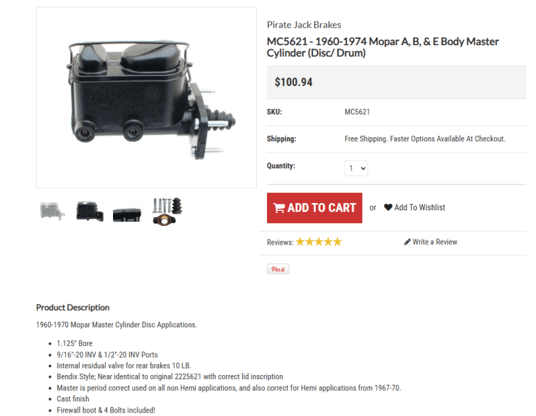

New fuel system is done now it's time to think about the brakes on the RR build. I going to go with non-power disc/ drum on the car and found this MC.
If I go with this I would not have to put an adjustable valve on the rears? and use a stock distribution block? Anyone go this route?
Thanks :p
That is a big bore for manual disc brakes. You will need a strong leg. The master cyl.has nothing to do with brake proportioning.
That unit is too big for a manual system. It would be fine for power brakes though.
Going over 1.03 for a manual brake setup means a lot more pedal effort than most people would like.

A basic 11" front disc setup like what came stock on 1973-76 A body cars, coupled with 10" rear drums and either a 15/16" manual master cylinder or a 1 1/16" master cylinder and stock vacuum booster work quite well.
