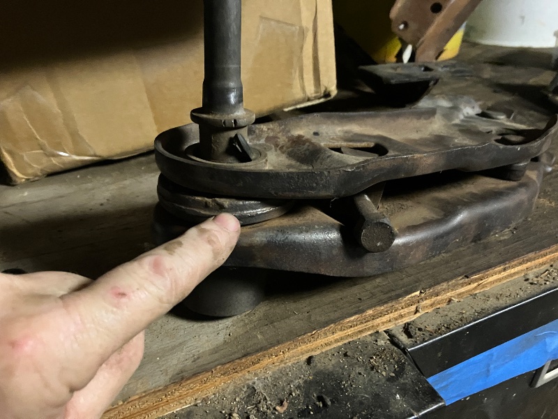

The blade is the “finger” that rotates in the arm as the suspension travels.

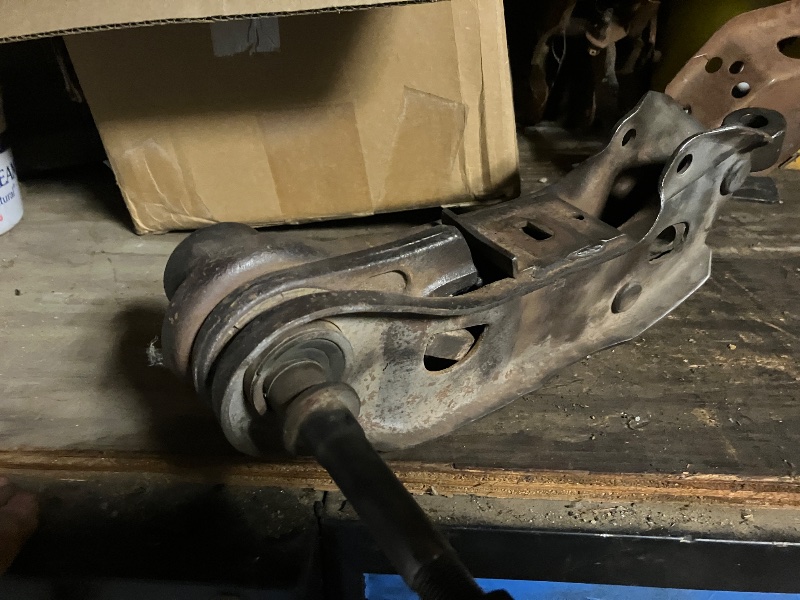

Rotated to where it sits when in the car…

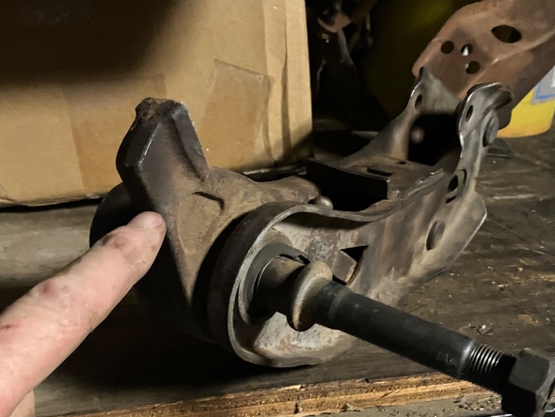

My guess is that the lowest point of the blade is this area.
