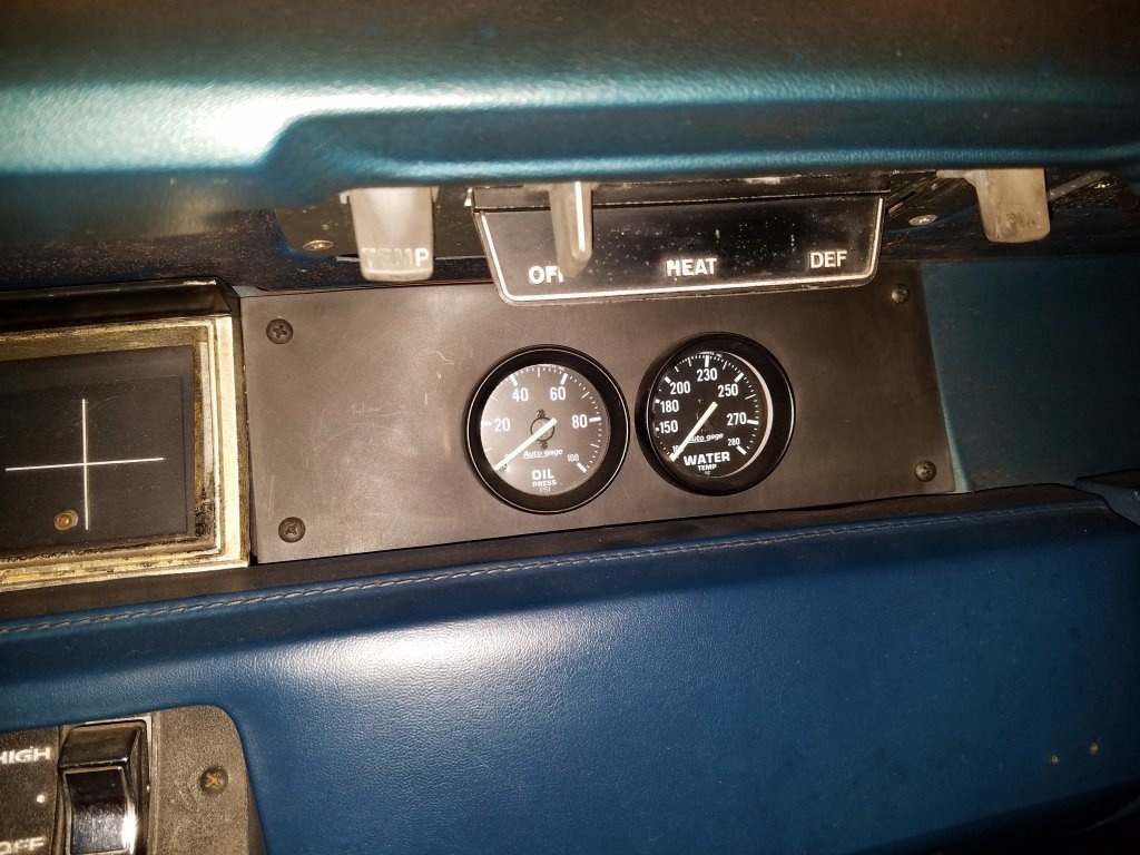

these 2 mechanical gauges have been in my 69 RR dash over 20 yrs. Both lines are 1/8 in approximately . I didn't drill any holes, used ones already there. if I remember correctly, they did have anew under dash mount.........
Can't read manufacturer name on gauge, can you post it, Thanks. Exactly what I'm looking for!
69 Runner is correct
still available n cheap, like I said ,flawless after 20+ yrs

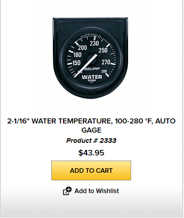

I was able to enlarge photo and the manufacturer is Auto Meter, connector diameter is much smaller than the Stewart Warner Gauge. Here's a pic incase anyone else is looking for one.
Pretty much all mechanical water temp gauges are going to have a bourdon tube that needs a 1/2-5/8" hole to pass through as they're not removable from the gauge. Usually you can remove a grommet from an existing pass through on the firewall, like the speedo cable, etc. and force the tube/nut through the grommet and then replace it on the firewall.
