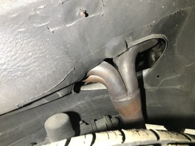

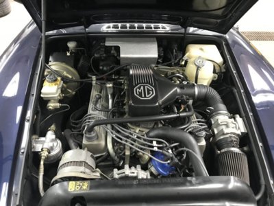

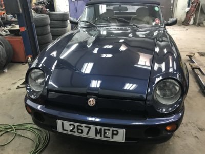

client bought this mgb rover v8 I think its a 1992.
I like how the factory engineers fit the v8 in it
with headers going through the fender skirts
and the car is fast.

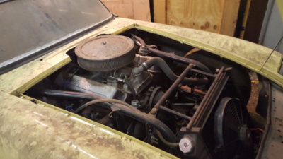

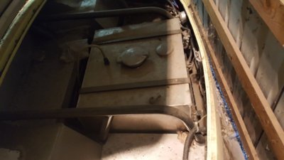

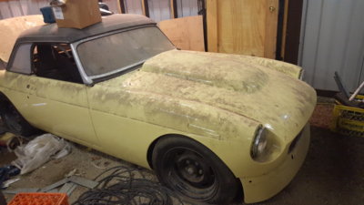

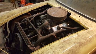

20180410_155100.jpg 20180410_155124.jpg 20180410_155142.jpg 20180410_155307.jpg Hey that looks pretty good! I have one thats been an on going project and needs to get finished one of these days. Sorry its a sbc and sorry for the mess. Its been sitting to long! lol
that cool , did you add a frame tubing
The car started as something to go run some slaloms and hill climbs. It got a little out of hand while I was building it so now it has a full tube chassis with a four link and panhard bar in back and custom upper and lower control arms in front with Aspen spindles. It has an 8 3/4 diff with 411 gears. The cop car wheels were perfect as they look similar to the original wheels. The engine ran 11.50s in a 3000 lb car so its healthy enough. The only thing MGB is the rack and pinion and the body. The whole car is pretty stealthy with the hard top on. It`ll be alot of fun when its done!
