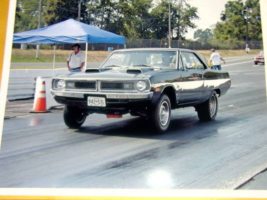

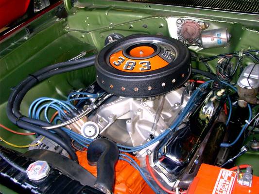

We run a mild 400 in my sons Dart which is a street car. Its a .030 over 400 with a 383 forged crank (406 cubes). Its a stock 400 block with .030 over KB pistons. We use Eddy RPM heads that were shaved to give it 10.6 pump gas friendly comp. He runs the MP .557 cam and Crane ductile iron adjustable rockers. Has an Eddy RPM intake with a Holley 750 DP. CPPA 2" headers and 3" exh. Uses a stock Mopar electronic dist I recurved and MSD 6A ign. Runs a 727 with a A & A reverse manual valve body and uses a Luppo Dynamic 9.5 converter that will flash about 4000 rpm and drives like a normal car on the street. I also use a Dynamic 9.5 converter in my street car and we love their converters as they work very good in our cars. He runs 3.91 gears and is now using M/T SS drag radial tires. His Dart is not lightened any as it weighs 3640 with him in it and about 1/2 tank of gas. His best et driving to the track and racing in street trim is 11.41 @ 117. Hope this helps you some and if you want any more info just PM me or email me at rn383man@yahoo.com. Ron
The 400 eng.
His Dart.
The 400 eng.
His Dart.
