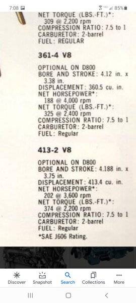

The print is pretty small/ blurry but the compression of a 413 industrial is rated at 7.5:1. That is probably with a .020 head gasket. If the compression is overrated like most mass produced engines its potentially even lower. I have yet to see any info on head cc's for a industrial motor, but even with a 75cc edelbrock perhaps it would be 8.5:1.
The short block is likely the only part that will work for a car. Which means a automotive waterpump housing, heads, intake, oil pan, motor mounts and accessory drive, shorter push rods, distributer will all need to be found/bought. Some industrial engines have a 8 bolt crank flange as well. You have a good shot at a rv engine being low miles, but its not a good donor. Unless you have the rest of the parts you need. If its car style 413, that would make life better for sure.
This is the specs blown up.. Hughes whiplash would sound mean and run pretty good with low compression. I would consider it.
