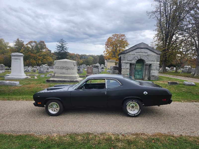

My first Big block :D
1969 out of a chrysler new yorker. Ill be swapping it into a 71 Duster. with a 727 and 3.73 suregrip rear.

Great looking Duster !

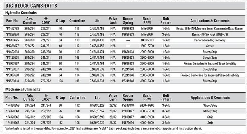

I use the Mopar Performance Magnum cam in my big blocks. This is the one used in 383 RoadRunner and 440 Magnum factory engines. It has a nice rumble at idle, and pulls smoothly to 5500 rpm. Pretty hard to beat factory engineering for a street motor. It gives good vacuum for power brakes. About 284 degrees duration and .480" lift. If you get into a cam with more lift, you are looking at a valve spring change.
