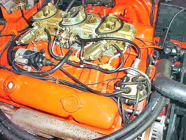

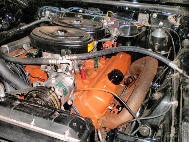

This will do just a little over 17 mpg if I drive sensibly,4 spd,3.54 Dana,the black one around 15 mpg.
