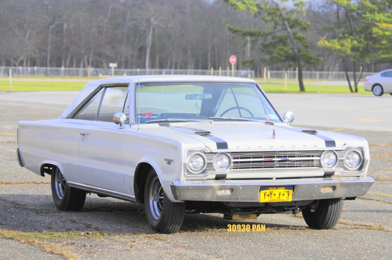

Cranky, i'm running the 30930 pan, the center link is close but clears on my 67 gtx you should have no problems the 31010 is a little deeper i gotta put a skid plate on mine over the winter every time i go over the railroad track crossing i pucker ;-) _DSC2336-001.jpg
