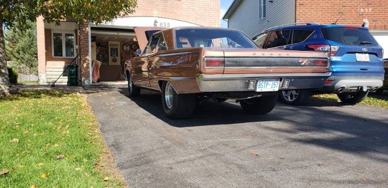

Here's a 67 with 315s 60 r15.

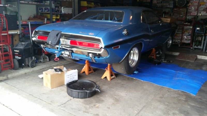

Love 315's. Have them on my Challenger. The wheels are off at Weld Wheels now getting polished double bead locks done.

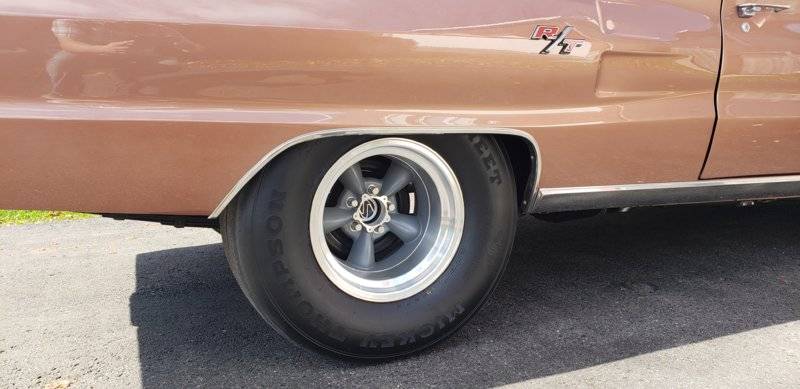

Stock suspension.
Year One 17" x 9" wide, 5" backspacing rear wheels.
315/35/17 Toyo Proxes TQ drag radials
Fit so well, centered and ZERO rubbing, they should have come from the factory this way.
Ultimately I am looking for rear tire width like this, minimum.
