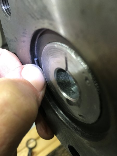

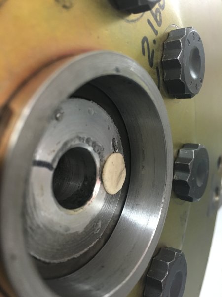

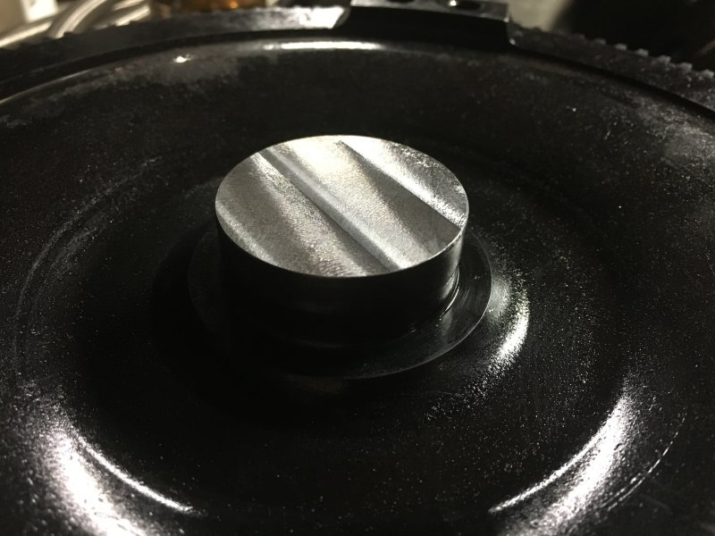

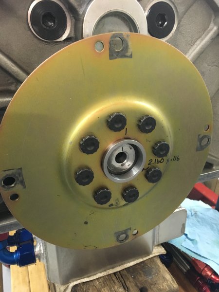

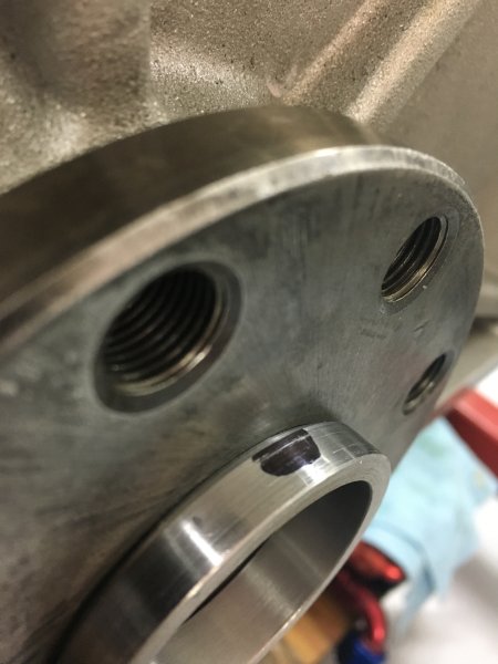

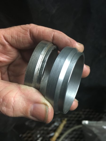

I bought a motor back around 2018 that has a crank like a top fuel with no converter register machined on the flange but had an adapter ring for a register. It has a slight press fit to stay in the crank.
It had an ID that was a bit loose to me for my converter so I had a machinist friend turn me another with a tighter fit.

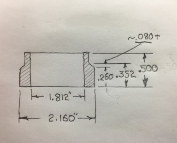

I saw your post and remember having this drawing I made for my buddy and "appears" I put 2 thou for the slip fit. Dug up some supporting pics.
Converter nose was bottoming out so I shaved it a little too.

Thank you, that's what I needed. If that worked for you, I'm sure it will work for me.
