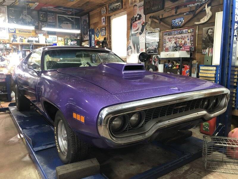

Hey Gang, getting to the end of my third build on my 1st car that I’ve had since 1979. It’s a 71 Satellite Sebring Plus that my dad and I worked on when I was 15. Anyway I want to pick up a mini starter that’s going to give me many years of service. Would you folks be able to recommend one? Thanks in advance for your help.

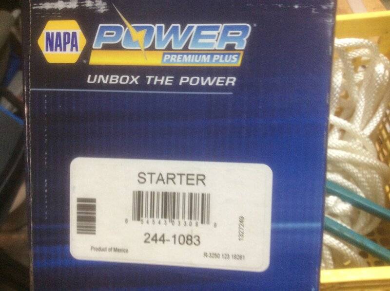

Got one at NAPA $60. Had to remove a plastic terminal cover and remove the extension leads.NOBIG DEAL.
