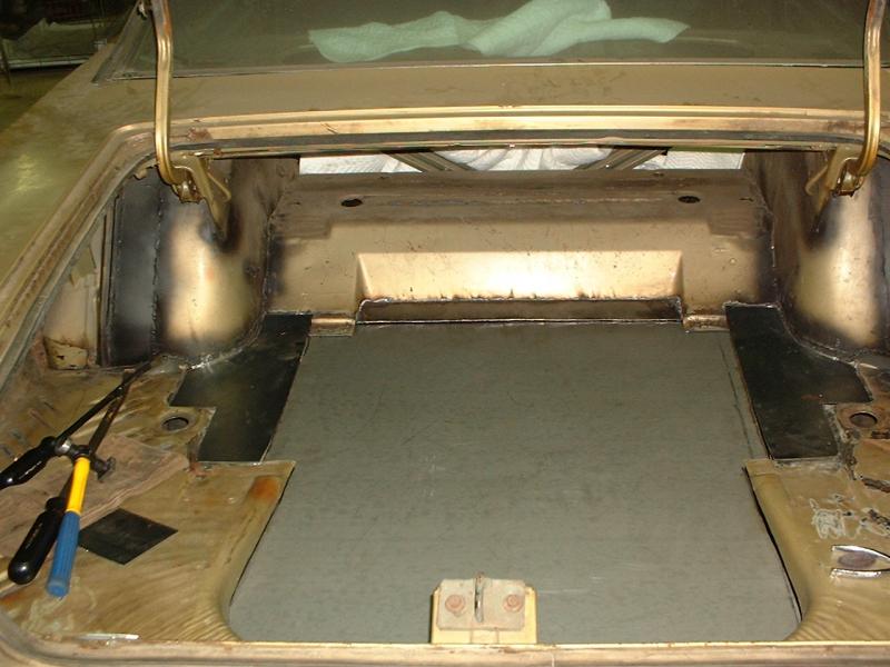

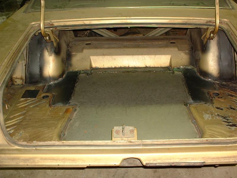

Well, I wish I could tell you that I did that on my'67 Coronet, but I didn't. I cut out the spare well and moved the gas tank to inside the trunk, above the axle. The tail pipes will exit from the backup light holes in my '70 RR rear bumper. Gas cap is on top of the quarter like a '69 Charger. Wells are tubbed to the frame and i'm about to cut and paste the leaf spring relocation kit soon. It's sitting on the floor waiting.
I also cut the spare tire well out on my 66....

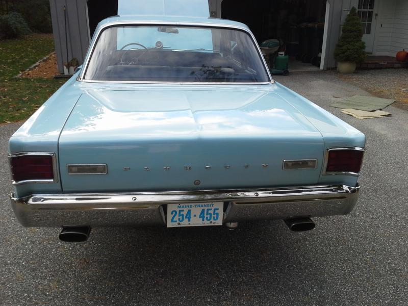

Here is mine with moved springs (no mini tubs though), fuel cell in trunk and 2 1/2" pipes.

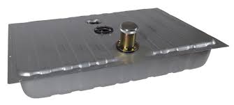

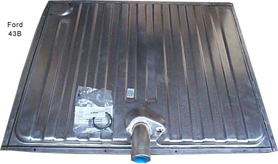

OK so I've decided to cut the spare tire well out. I'm thinking to use a Ford gas tank (Yea I know) like the ones below. The Fairlane tank seems promising as it is 30 1/2" wide flange to flange. The stock spare tire well area after removing the well, should allow for this to drop in with very little addition modifications other than cutting the proper size hole. then the gas tank and spare well are taking care of at the same time and no bulky fuel cell in the trunk. The top of the Ford tank would be the finished trunk floor. Then either weld on a filler cap flange and fill from the trunk or reroute the filler tube inside the trunk.
FORD FAIRLANE & TORINO
1966-69 Fairlane, 1968-69 Torino includes 2 door & 4 door sedan, hardtop. (except station wagons). 20 gallon, (30-1/2"X37-3/4"X8-1/2") without drain plug, high quality Ni-terne plated steel gas tank. Includes lock ring & gasket for sending
MUSTANG & COUGER
FITS:
Mustang: 1964,1965,1966,1967,1968
Cougar: 1964,1965,1966,1967,1968
Made by SPI and of High quality Ni-terne plated steel gas tank with 3-year warranty and comes with drain plug, also Includes rubber O-ring & lock ring for sending unit.
Size: 16 gallons. Dimensions: 32-5/8" x 24-1/2" x 8"
Replaces Ford Original Part Number: C5ZZ9002D
That's an idea...never thought of that. I originally cut my spare well out because there was some rot involved, and I intended to run the exhaust out those back up light holes in the '70 RR bumper and didn't want to run them around the well first. Then several show cars came to my attention that had things about them that I really liked such as the tank over the axle sandwiched between the tubs. I still haven't welded the trunk floor in place as I'm wanting to sit on the floor and weld up the relocation kit so I don't have to lay down and do it upside down. I also considered a flat RR type pan for the trunk as it will weld right up with a bit of trimming. You have good ideas, nice to see another hot rodder making some mods too! Good luck. Ghost

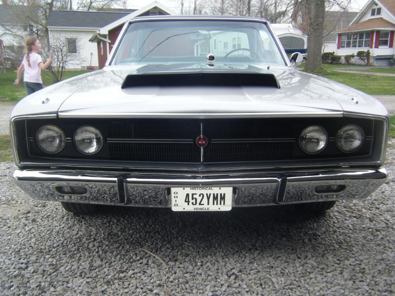

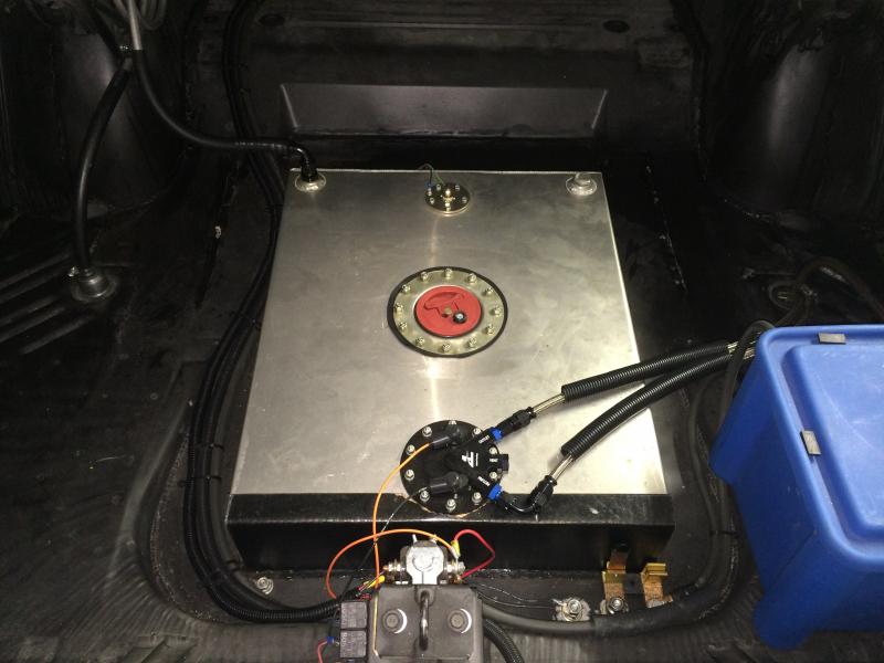

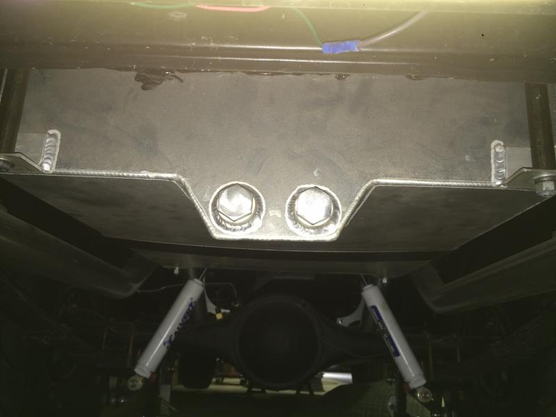

Here's a picture of my 67. I used a 20 fuel cell and sunk it down just below the bumper.

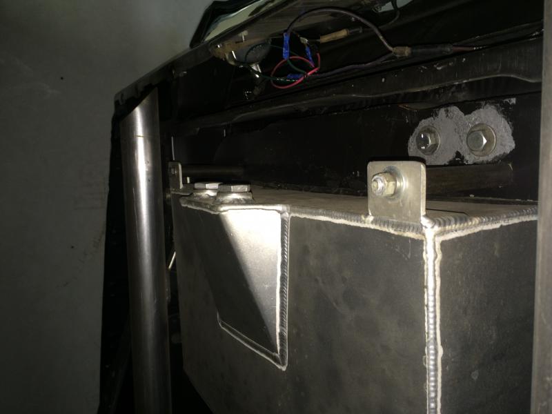

What I did was cut out the spare tire tub and weld a floor in close to flat. Then I cut out the floor for the fuel cell and sealed it with seam sealer. It is bolted in on all four corners plus I added a strap in the middle for more support.

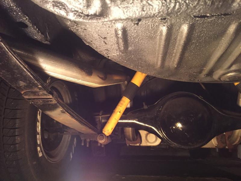

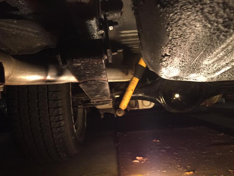

Then I used a tti exhaust system for a 68-70 b body.
It now has a fuel pump in the tank because I fuel injected my car.

I am planning on either running the 64' mustang tank or a cell like you did. I am going to go with the Aerotech Phantom intank pump with whatever I choose. I would love to see some pics of what you did.

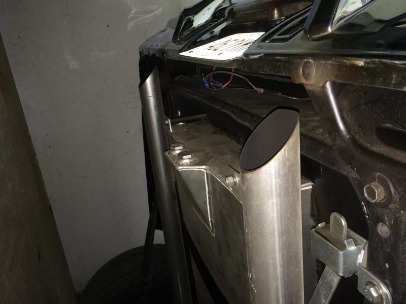

Here are a few more pictures. It's in storage right now so I don't have good lighting. I took a lot of detailed pictures of tubbing and moving in the leaf springs but none of the fuel cell so here are some pictures I just took.
Sorry for posting the pictures that aren't relevant.
On the trunk floor I kept it flat instead of following the contour of the trunk. It tends to go up as it goes to the bumper.
