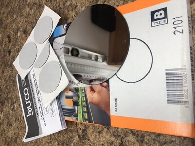

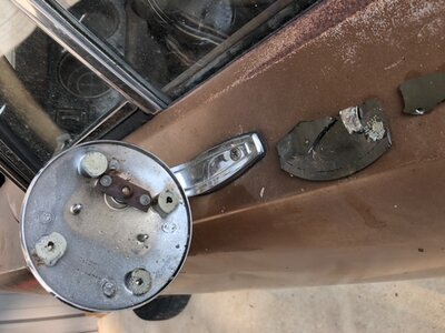

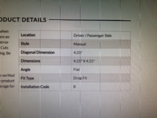

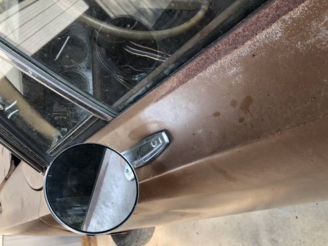

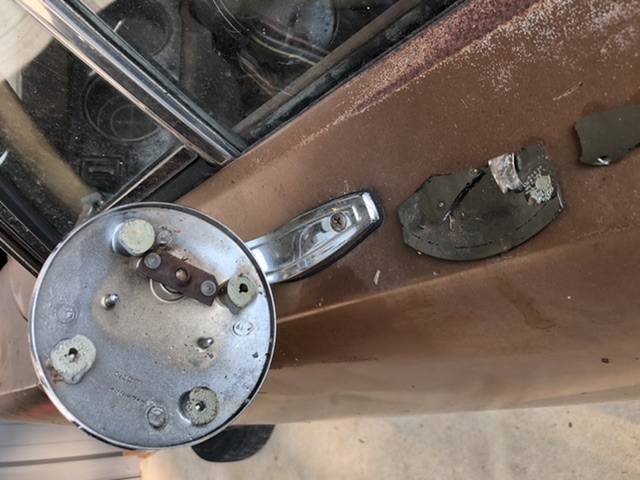

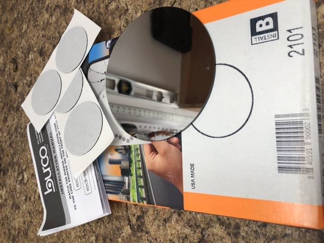

I found this thread while searching for a replacement manual side mirror glass on my '70 RR. Ended up ordering from Burco, they didn't list my car, but P/N 2101 (4.25" round) is listed for other similar cars. I used the adhesive pads included with the kit to install. I'm happy with the results and thought I'd share for people searching this in the future.
