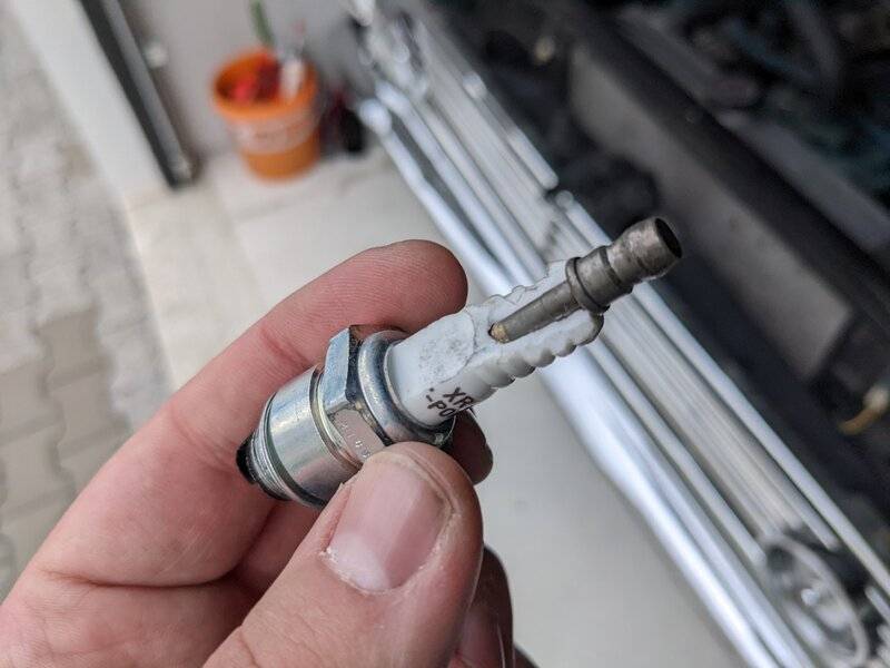

Now I started to change the spark plugs.
Before Autolite 85, now NGK xr5 3332
One plug was really shitty to tighten (second from the front, driver's side), because everything is in the way.
Well, I took the plugs off and put them on one by one so as not to mix up anything.
It starts noticeably better now, is right there.
However, it now misfires on mass under load. In addition, the warmer it gets, the crappier and more jerky it runs. It's really bad, I can't
I can only let it roll.

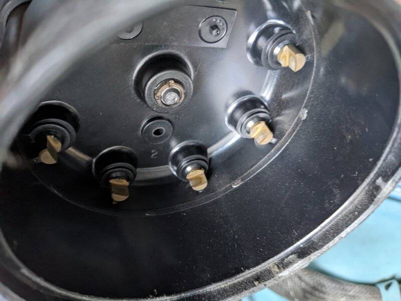

I suspect the distributor cap because the carbon pin no longer looks good to me.
Maybe it broke off somehow when I plugged it on and off?

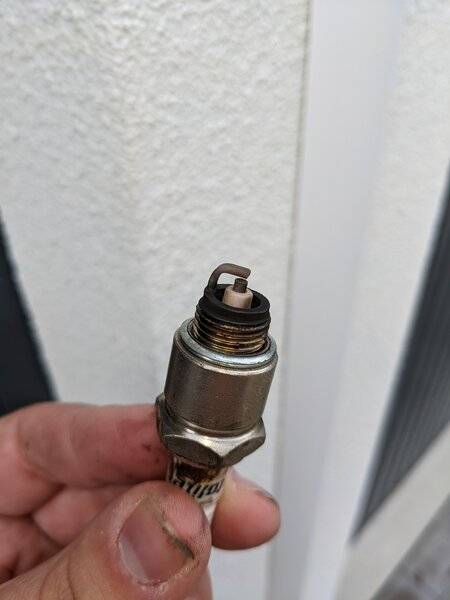

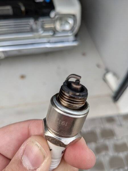

You can clean up and put the old plugs in, or pull wires to check if there is a specific cylinder causing the misfire. If this is a stock iron head build I would just stick with the autolites.
Well you did not have that problem before so you did something. Double check your firing order. If ok pull one wire at a time and see if it changes anything. It might help pinpoint it to one cylinder. If nothing is found pull the plugs and inspect them. Start with the one you had troubles with. You could of cracked the porcelain.
Looks like the carbon contact in the center of the dizzy cap is broke off. Need a clearer picture.
It looks to be there but has some wear. If the rotor is ok and still hitting it ok I doubt that is the problem.

Also, If you drop a plug you are not supposed to use it.
I dont know anymore, but it can be possible that I dropped one. The Spark plugs are the old ones
I will test the old plugs on monday
But from this I also dropped one...

That cap looks fine , you could have cracked the porcelain on a plug , damaged a wire pulling the boot off the plug now you have spark either jumping to ground , or no longer connected to the electrode . Or when you screwed the plug in , gunked it up with old dirt and oil near the holes.

i agree with glenns hc, most likely you cracked a spark plug insulator on the install or in handling the plug wires created an open. take out all the plugs and looked for cracks, ohm out all the wires.

One of my old Autolite were dropped and I need to open the gap. But also with this issue it's run so good.
