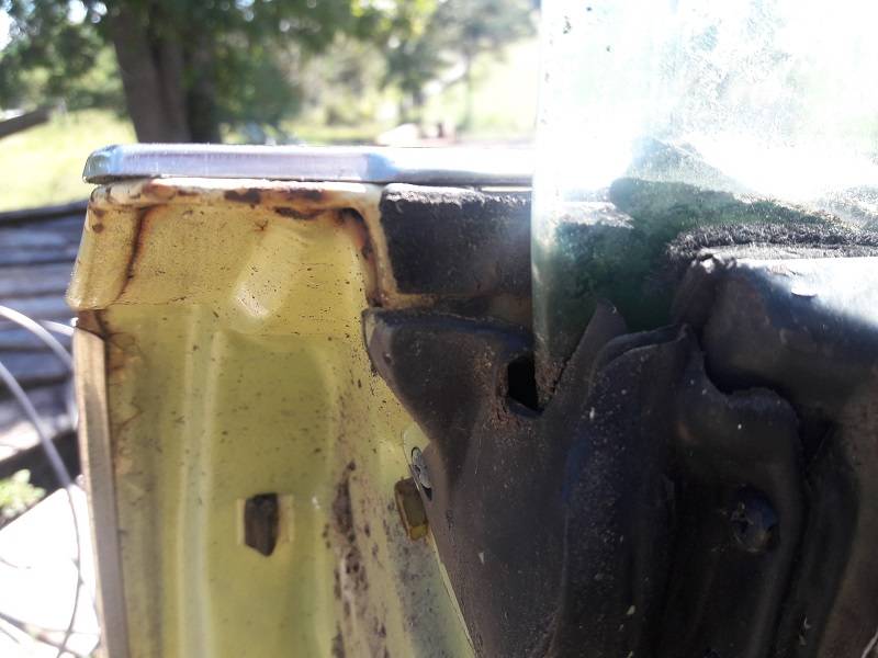

Hello,
I have a 69 coronet and a 69 road runner. Looking at the outer door felt (wrong word) on both cars at the rear of the door, there is about a 2" area that seems to be missing a piece. There is a hole there but I was just wondering if something was ever there, like a little extension piece? Or why didn't they make the outer piece longer?
Just asking,
Greg

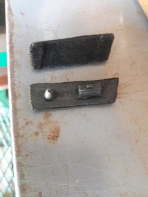

On the 68 to 70 B-Body two door hardtops and sedans, they used a door end plug to finish out the window felt. Most people do not even realize that they are missing upon pointing it out to them. They are relatively inexpensive, $15.00 per set and just finishes out the area to make it look more finished.
Most of the larger retailers should have them available as I know that we sell them to compliment the window felts.
That's them! You mentioned you sell them? I would like a couple sets if you could point me to where I can buy them.
Thanks,
Greg
