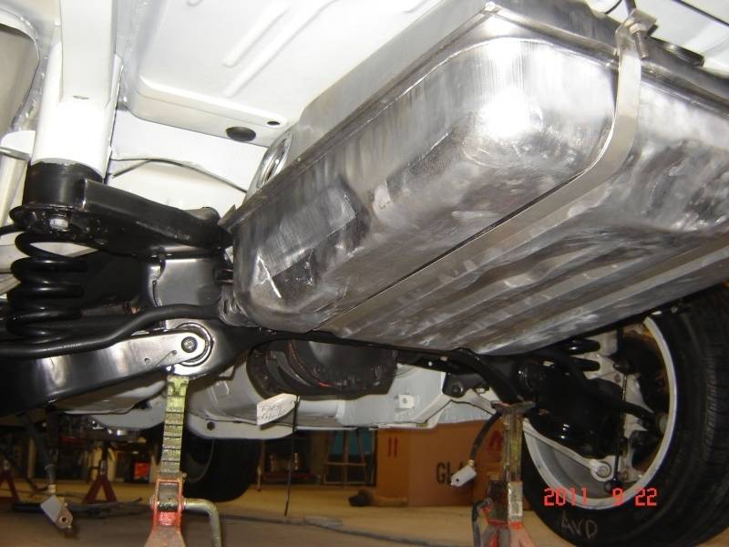

Aside from the width issues, you might want to take a look at how tall it is. I decided not to try the break from an 07 Charger in my 70 GTX build because I would have had to cut into my package tray to make it fit in that area.
Local guy did that swap on his Cuda. Was lot of work, 1,5 in wider than stock. Use different offsert wheels
Got any more pics of how that guy installed it in his cuda. That looks pretty sweet. I was asking because we have a 73 roadrunner shell we have been playing with . And bought a wrecked 300. Pulling everything out the 300. Thought we could do a resto of a roadrunner but all modern like a 300. Something a bit safer for him to drive
