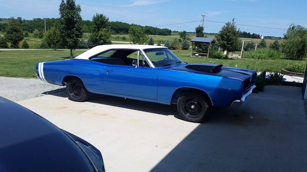

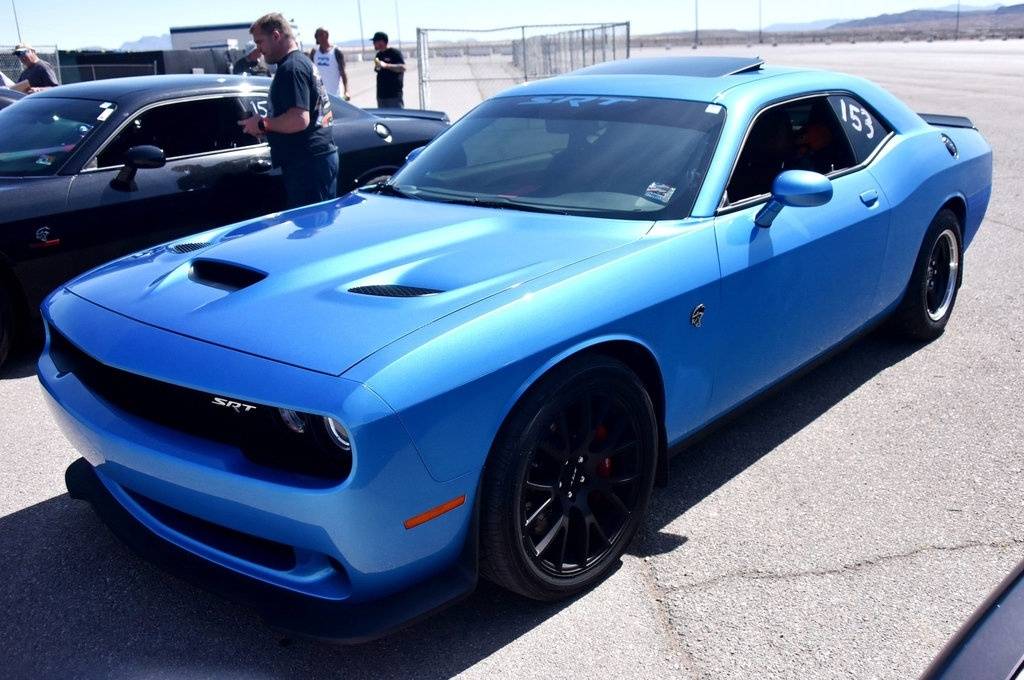

This is jeep hydro blue metallic. Code PBJ. I believe 2014 to present.

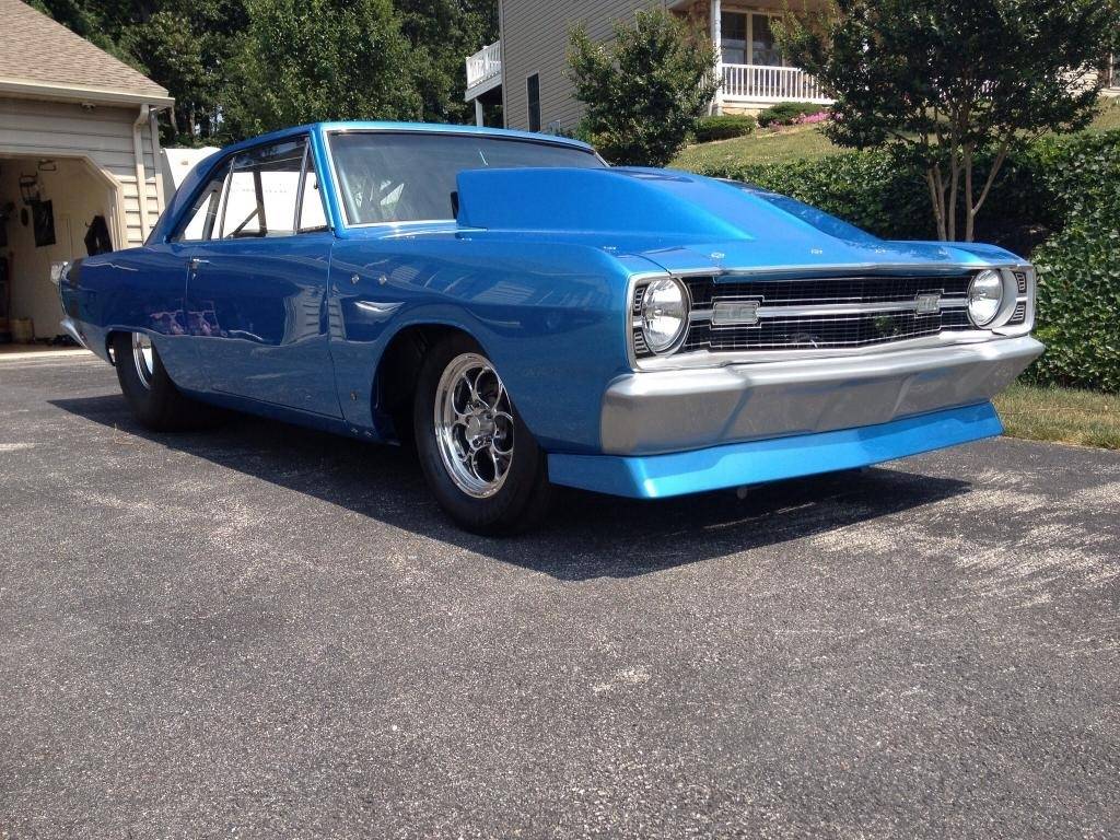

When B5 came back I painted a 69 Dart in it, ~2011. At the time it wasn't in the PPG system yet but kept showing up as Surf Blue. Turned out it was already a color the Chrysler had in the hopper.

I'll bet that car is the same color as the Dart. Photos make it pretty hard to look at color unless the two cars are in the same picture.

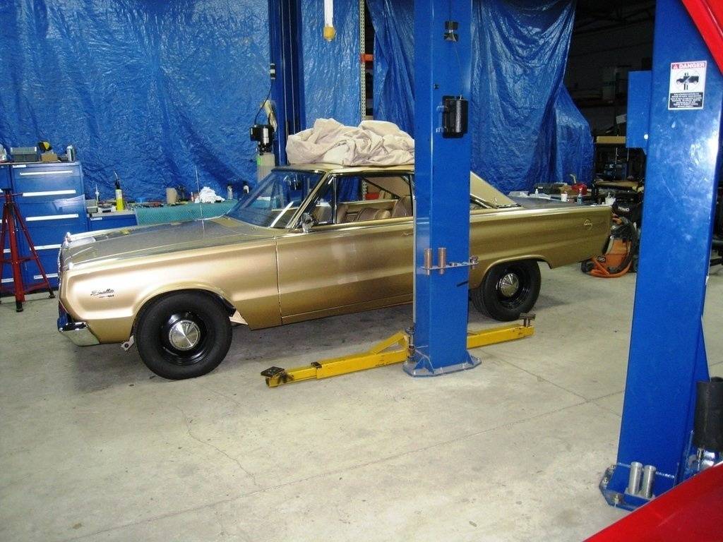

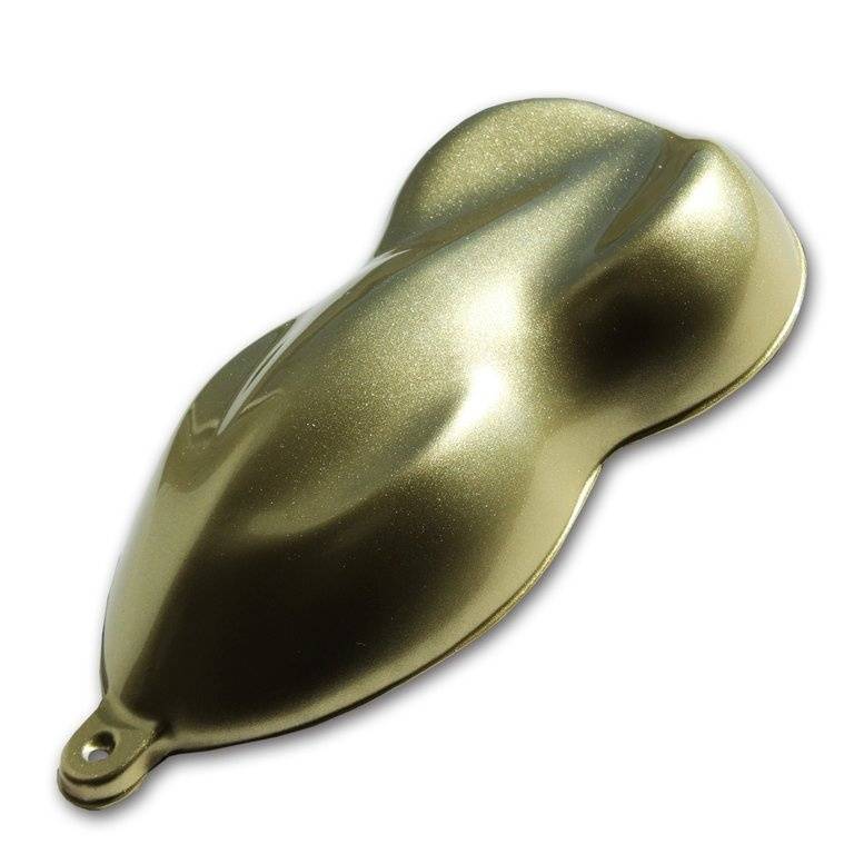

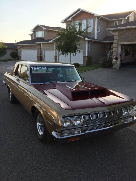

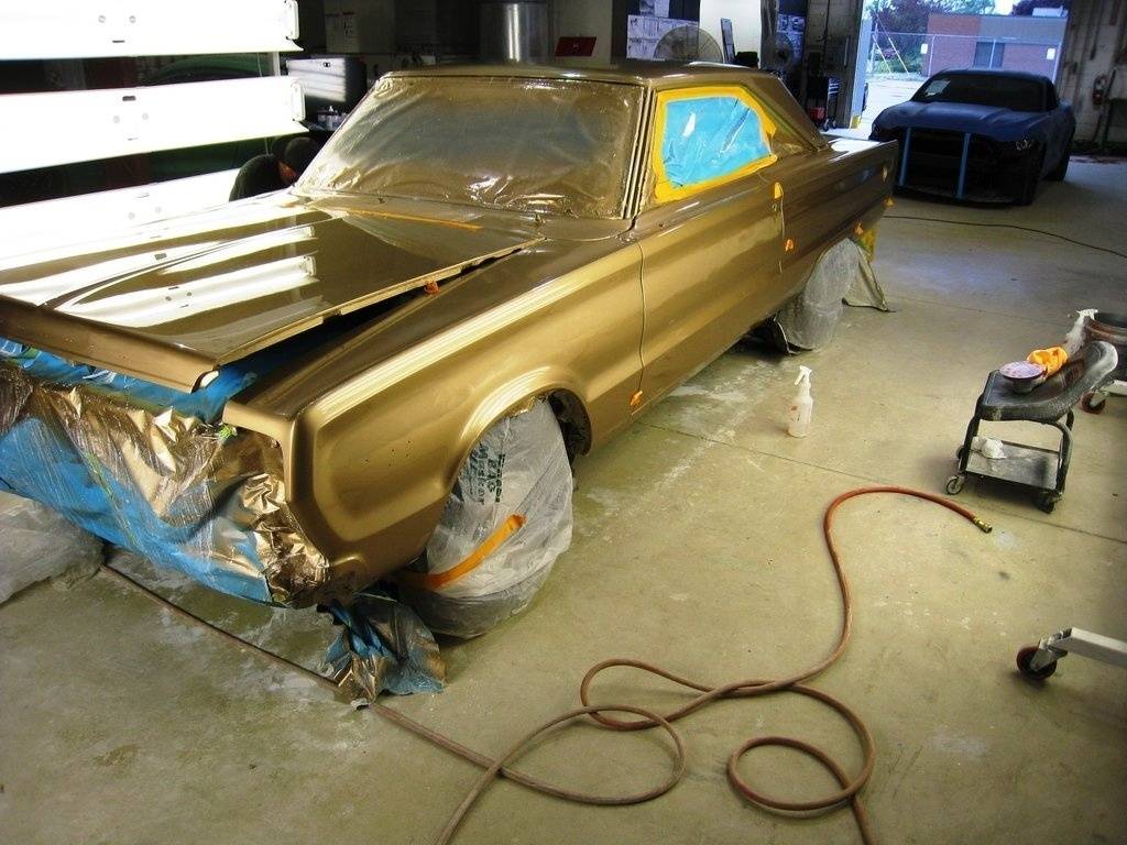

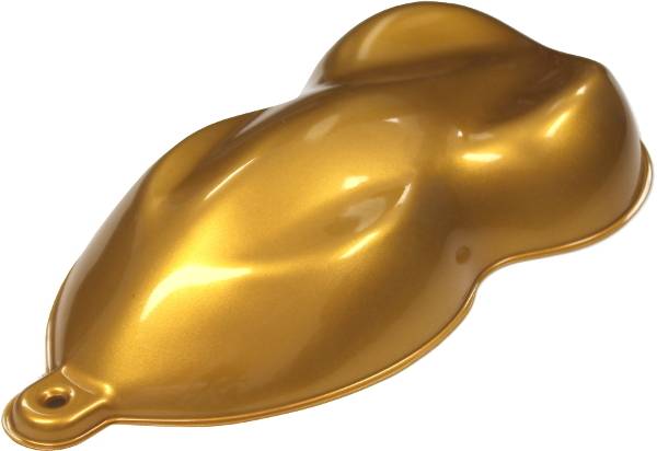

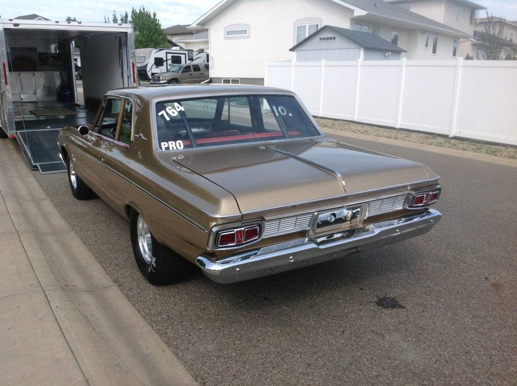

This is Egyptian Gold and Light Gold Metallic from The Coatings Store...also a couple of my picks...I think they would look awesome with a black vinyl top...
