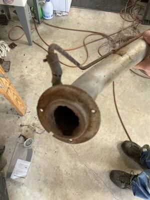

Here is a pic of the stock Charger filler tube showing the vent tube pnora mentioned. It goes down through the trunk floor and is inserted into the frame rail. It is the only vent and works well with my 6.1 application. Never had any pressure build up, vacuum issues or odors. ( pic from another thread on this site dealing with fuel venting)

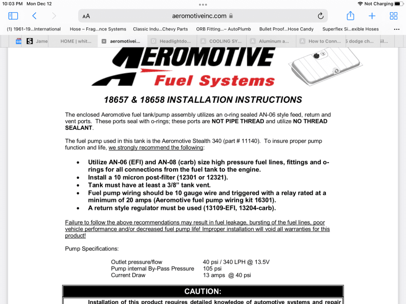

I’ve been over-thinking my vent setup for a 6.2 hellcat motor and stealth fuel tank being installed in a 69 Charger . The new fuel line is 3/8” and l’m thinking the stock vent is fine for fuel expansion but I need something bigger to allow air into the tank when operating at high hp. I think the line needs a 1-way check and filter. The line needs to terminate at the stock vent elevation or higher. I’m worried about vapor inside the car though so I’ll be interested in what you decide. I’m gonna ask the Aeromotive boys about it soon as well.
The Stealth tank instructions for a hellcat swapped charger say:
Factory ventilation will be retained as per OEM spec.
So the stock vent should be fine on your car.
