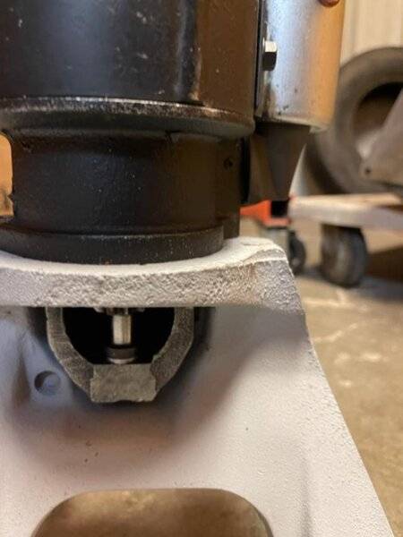

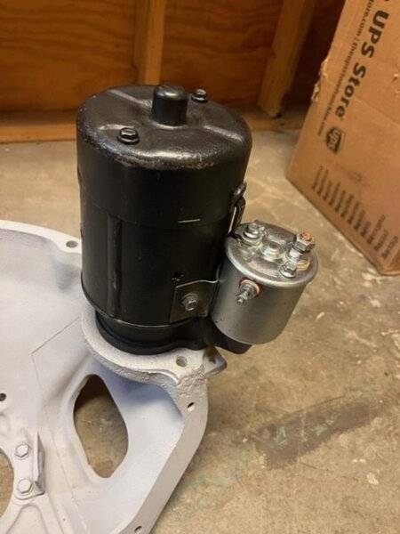

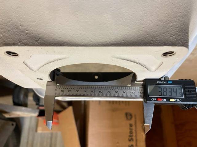

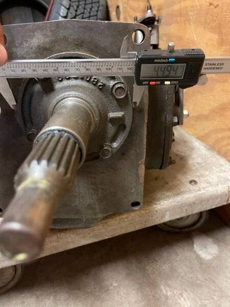

Has anyone ever increased the size of the retainer hole on a 67 A833 trans #2780512 to accept a 68 A833 4speed that has the larger diameter retainer? I have my 67 Hemi with the 172 tooth flywheel and the correct A833 bellhousing #2785012, 3.834" diameter retaining hole. The transmission I have is a 68 4 speed A833 which has a larger retainer, 4.494". I thought I could use a 68 Bellhousing, with a standard starter but that won't work with my 172 tooth flywheel, which requires the direct drive starter, which I also have. See photos any input is appreciated.

I did that mod years ago on a small block bell housing. Honestly, all I did was ruin the bell housing. You have to get it perfectly bored on center. I did not know it at the time but all I had to do was just replace the bearing retainer and it would fit. I would not bore it out. You have a valuable bell housing there in that 66-67 piece.
It’s not that easy in your case, but you can fix it and save the machining on the bell housing. I’d get a 66-67 case with the smaller 307 bearing. That’s correct for you car. They are easy to find. Just swap out the front case. It probably needs seals and synchros anyway. Brewers performance has cases.

Glad you asked first. The 68 has the bigger bearing so you have to change the case. It’s not that hard with a good pair of snap ring pliers. If the synchros are good then you don’t even need to take the mainshaft apart. The hardest part would be to get the reverse idler shaft out. Look in your service manual for help.

Brewar's says that yes the retainer hole can be machined as there is enough room. In the alternative Brewar recommended the same as Fastmark, change the case to a 307 and use the smaller 307 bearing. But my trans book says I need the 308 for my 18 spline? Need some clarification on the case number for the Hemi 18 spline setup.

I think it would be pretty risky trying to machine the bellhousing unless it was a really good shop with precision equipment and a good set up. If out only a little off set dowels might take care of it but if out over, say maybe .02 ”, might be a complete loss.

A 307 bearing will work with the 18 spline input shaft. That is what the factory did in 66-67. Change the case, as stated above. It is the cheapest and best route.

I called Jamie Passon yesterday and he sold me what I need to make the changes using the 18 spline shaft/gears from my 68 transmission, so it will fit onto my 67 bellhousing with the 172 tooth flywheel.
Parts are the 307 case, bearing snap ring, retainer and correct throw out bearing. The 172 tooth flywheel is thicker than the 143 and requires a shorter throw out bearing. I have spent almost a year looking for the correct throw-out bearing for that very reason. I have bought multiple throw out bearings and returned for being the wrong size. Finally my luck yesterday was Jamie had a cancellation on a build and had the correct throw-out bearing for my build. Now the drivetrain will all be correct. Then I will have a 68 bellhousing to sell, a few new throw-out bearings and a correct 68 trans case for the next guy. Thanks to everyone for pointing me in the right direction.
