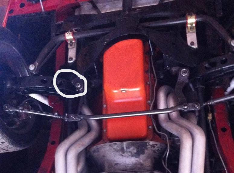

There are still issues to consider. Look at the white circled area:
That is one area that is already close. Moving the LCA forward just crowds it even more. The sway bar will now be hitting the LCA. There isn't much room to move the sway bar forward either. If you omit the sway bar, that is a backward move since it is crucial for good handling, losing it defeats any advantage from a gain in caster.
yeah, I looks quite close. Will have to put the Charger on my lift to see how cllse it really is. No point in losing the sway bar.

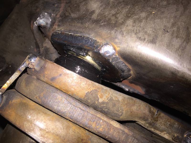

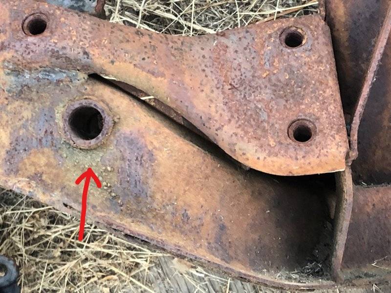

Shame, the reinforcement plate of that K-member hole for the LCA pin pushed back the LCA the thickness of that plate.
Not really, Steve.
If the welded in washer isn't sticking out further than the original "lip" of the tube the factory selded into the K members. This is a 73-76 A body unit, similar to all the B and E units.
