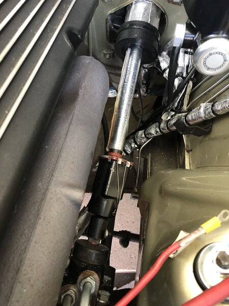

i did stuff some double sided foiled insulation into the tube about 4-5inches deep into the open end in the engine bay area. then capped it with a home depot plumbing section rubber cap for pvc. i didn’t want to pay the $$ for the mopar piece.
:rofl:
no noise for me but i was getting heat sent straight up the column. wrapped as much i could

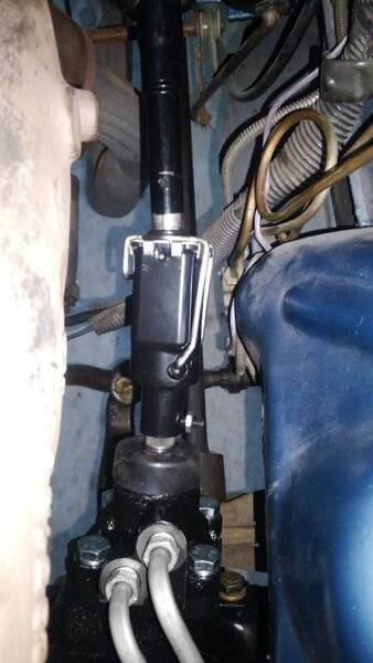

After doing both conversions my observation was that since the Borgeson box is unlike the OEM box in that the shaft intersects the steering column at an angle you can not go by the FSM directions as far as setting the "plunge" depth in the Bergman pot coupler. Photo shows how mine ended up, trying to shove the shaft further into the pot coupler as per FSM results in binding.
