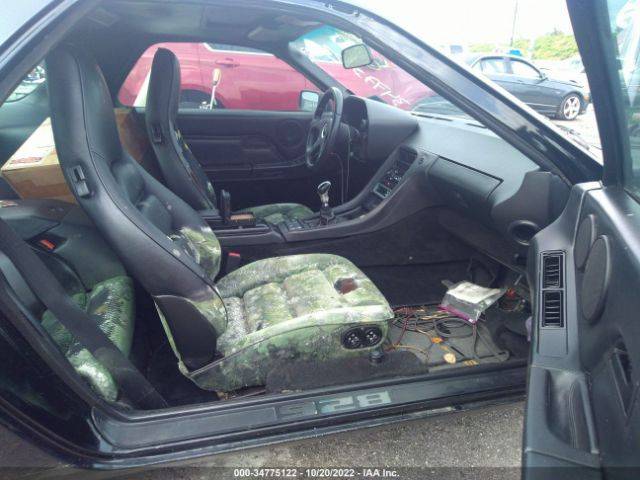

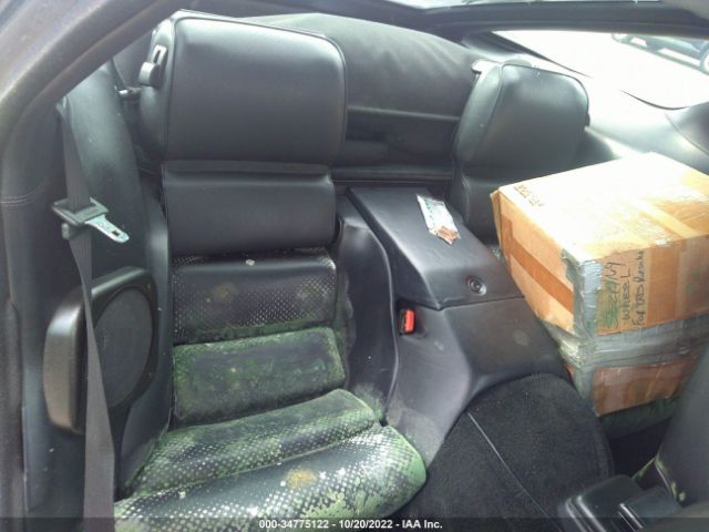

I thought you liked green?
Not mine!
:rofl:

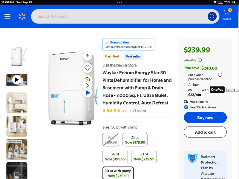

This will help but if the humidity is to high than you need to get dehumidifiers. I live in Virginia and the humidity in SC is just as bad if not worse than up here. I tried damp rid first but it wasn’t enough.I bought two 50 pint a day dehumidifiers with pumps and that solved my mold problems. I can get the humidity levels to 30%-40%, even with the outside humidity at 95%. This is what I have.
[/URL]
Yeah the humidity has been bad for several months here. I should have checked on the cars. I will be looking into one of them. Thanks
Make sure you get it with the pump. You can then run the drain hose any way you want to the outside. Mine is ran out the window. If you don’t have a pump it will still manually drain but the hose has to be oriented just so to get it to drain. I have one in my other garage that is manual drain and that’s how I know the pump is much better. If it doesn’t drain then it fills up the reservoir bucket on the unit and shuts off when full, and you have to manually empty the bucket to restart it. It only takes less than a day to fill the reservoir. You will be amazed at the amount of water it pulls out of the air. 5 to 8 gallons a day with one unit running. In contrast the damp rid pulls out maybe a cup of water a week. Don’t bother with the damp rid. Oh and my garage is 18x25 for comparison and I am running two units. I originally started with one and it helped immensely and got the humidity between 50%-60%, but I wanted it lower so I got the second one. Now it is 30%-40%
