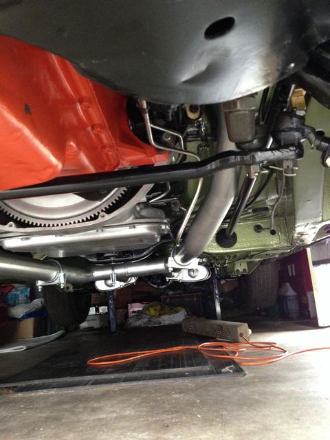

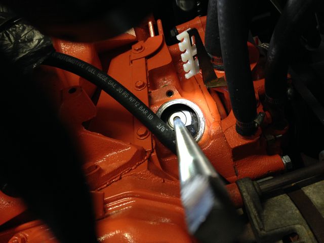

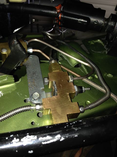

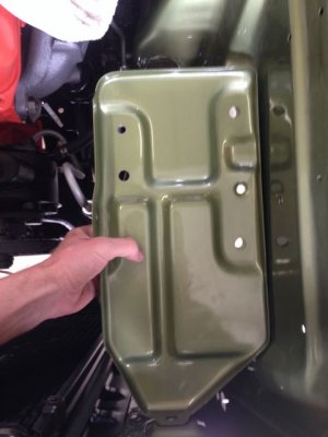

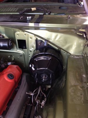

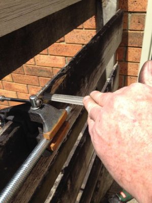

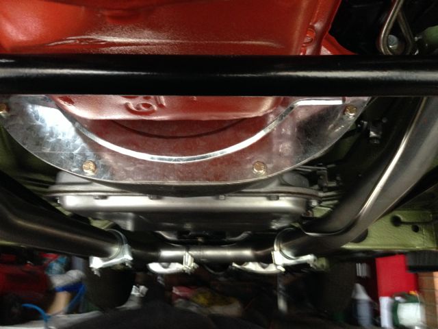

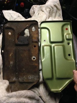

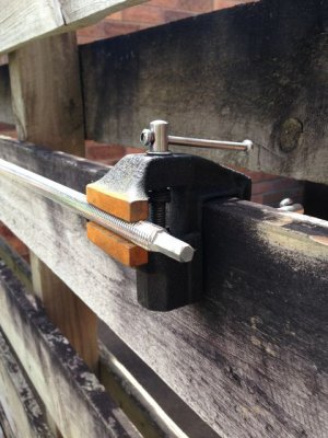

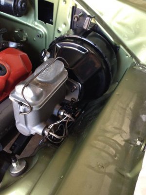

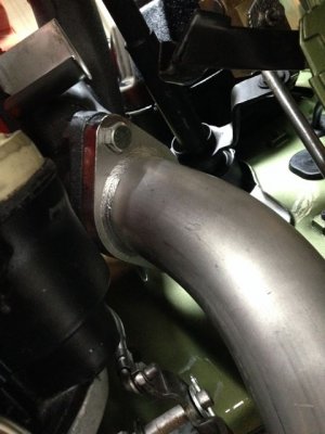

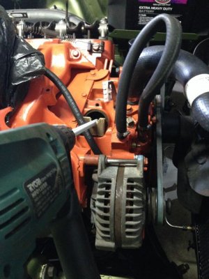

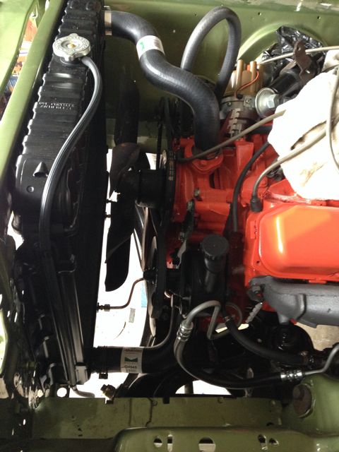

Have been fiddling a bit over the xmas break since my young bloke has been down here on leave and wants to see it running. Ordered a new battery tray but the hole was slightly different, so had to drill another. Fitted the TTI exhaust which went together well, but I think I may have to get a spacer made where the drivers side exhaust head meets the manifold, as it sits a bit skewif that side on the under belly. A little bit too close to the floor compared to the passenger side. It'll do at the moment just to run it. Had to make a couple of brake lines at the valves, as the old ones had rounded nuts, and I couldn't replace the nuts without making new pipe. I repainted the master cylinder cast iron grey as I wasn't too happy with the black, I think it looks better this way. I plan too remove a couple of things later and clean them up a bit better, but at the moment just trying to get it to running stage. Made a priming rod from some threaded bar which turned out ok, used my old oil pump to get the hex right. Tomorrows the big day. If you don't hear from me for awhile means it didn't go well.:sigh:
