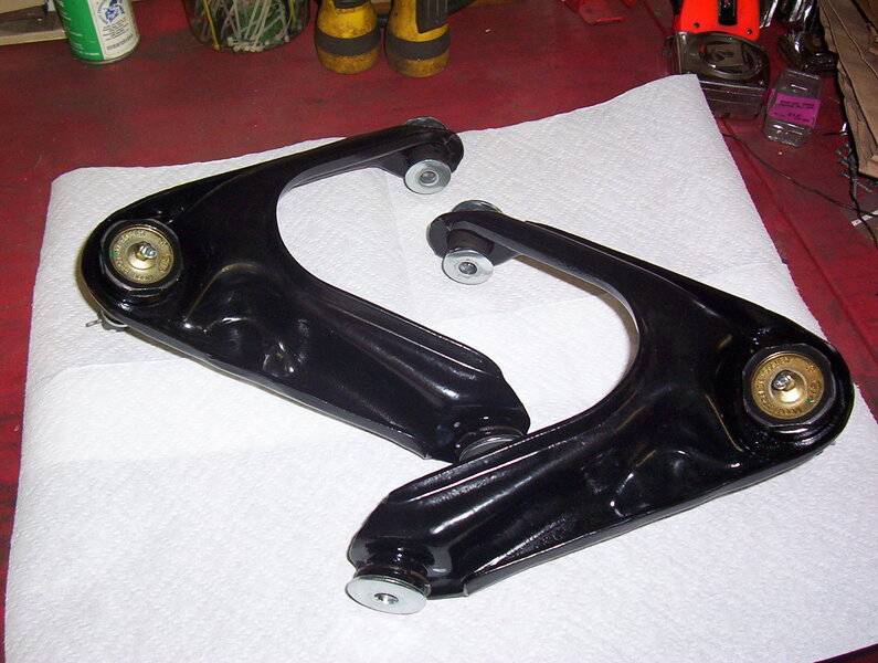

It might be hard to tell but the bushing's inner sleeve is offset. Sometimes when you look at the adjustment bolt you can see it is not centered in relation to the bushings location in the arm. Where if the bushing is standard non offset the bolt will look to be centered in the relationship of the bushing in the arm.
If you zoom in on these you can see the offset in relation to the arms socket.
I'll pull a wheel off this weekend to get my head in better and see. Thanks
