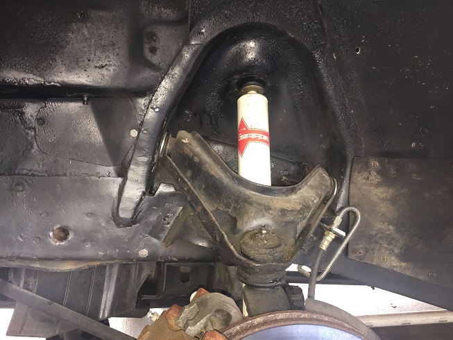

I want to go through my front end and make it drive like new oem again. Anyone know all the parts I will need, or a link to a thread.
Also, I have never rebuilt an entire front end myself before. Obviously I could run into some issues and end up needing more than just rebuild rubber, so any advice about handling the control arms and what special tools I might need.
upper ball joint K772
lower ball joint rt K781
lower ball joint lt K783
idler arm K041
control arm bushing kit
lower K408
upper ?
tie rod ends
drivers side inside ES401L
drivers side outer ES401R
passenger side inside ES401L
passenger side outer ES401R
Not sure the tie rod end numbers are MOG but what i have on file. You will all so need an upper ball joint socket (maybe able to rent it from O Rilleys or Auto Zone), large pickle fork,lower ball joint remover, press, big hammer, pry bars and maybe liquid wrench. Patients and alot of luck.
