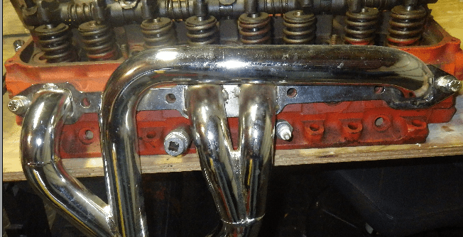

I know approximately 400 million posts have existed about header bolts leaking on a 440. I don’t have a question as I have read all of them. I’m just saying that this has to be the worst design in the history of engines. Hope this Harvey’s TFT paste works because permatex thread sealer did not.
If you read a bunch of threads about it you must know that the reason the studs are better is they have a shoulder on them which seals against the head. However, I am also aware that trying to fit headers with the engine installed creates issues with clearance over the studs. You're damned if you do & damned if you don't! :(
Yep...Worst design ever...Stud it and deal with lifting the motor whenever you wanna do anything...OR deal with putting HP manifolds on it...

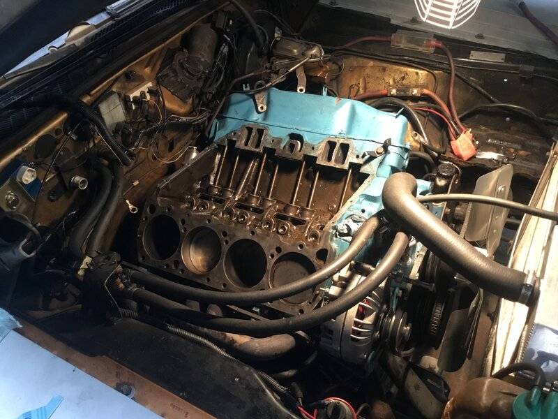

I just did head gaskets on mine and it exactly reminds me of why I don’t like headers…

you can use a stud like a bolt with the headers in place, just double nut the end locking the nuts together, install with sealant ,tape , what ever, run the stud in tight , break the nuts apart with 2 wrenches, remove outer nut, tighten down header
Worst design ? Hardly. Studs & one bolt with sealant on the pipe with minimal access. Been working without problems for 50 years + ...
