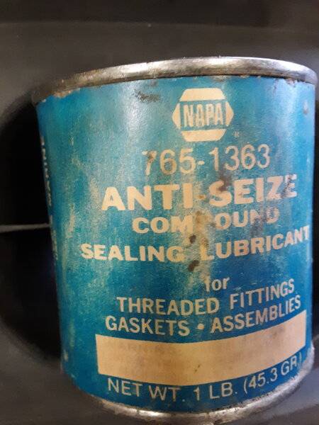

This napa sealer is also a anti seize.
It's for hydraulics and steam fittings.
It is a lead base sealer.
Never had a header bolt or stud leak using this.
