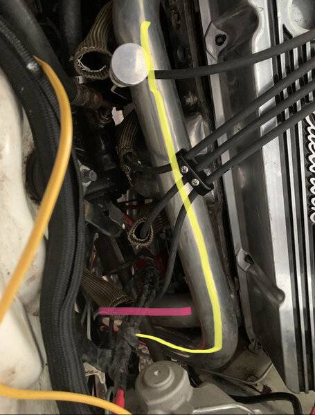

I just bought a 67 charger with a 440 big block that the guy sold because of health reasons. I think the 440 is of the motor home flavor from the late 70’s. Any who, I just put some summit racing headers on and fired it up for the first time. After idling for ~ 5 minutes, the number 7 header is glowing red. Engine is around 190° I know the typical answers are timing, and it is too lean, however I am skeptical this is the case due to only one pipe glowing.
Either tomorrow or the next day I am going to check timing with a light, and compression on that cylinder. Any old head have any other advice for me? Plugs show a lean running engine. I am also wondering if the proximity of the other header pipe could be causing the # 7 pipe to heat up from the radiating heat.

red is the one glowing and yellow is the one that is close to the #7 cylinder.
View attachment 1149858 View attachment 1149859
