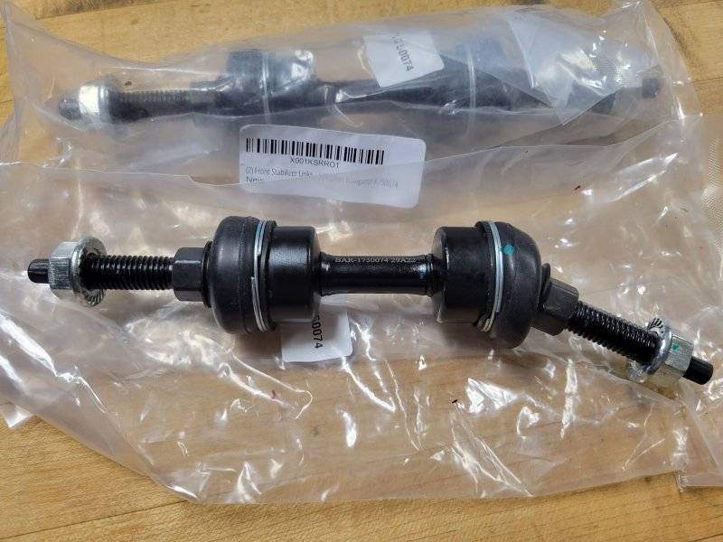

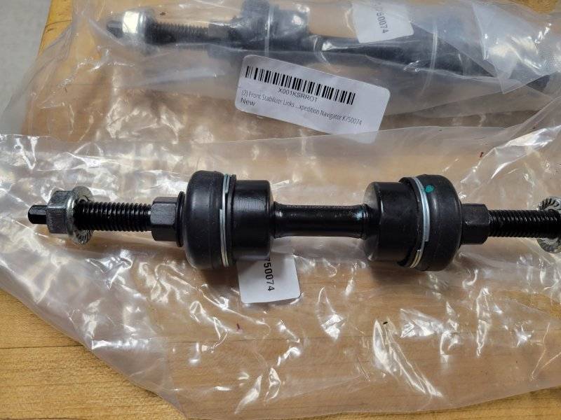

Anyone got a pic of the fomoco part?
I have an aftermarket front bar on a car built without a bar.
The aftermarket links are just "plain".
Interesting.
