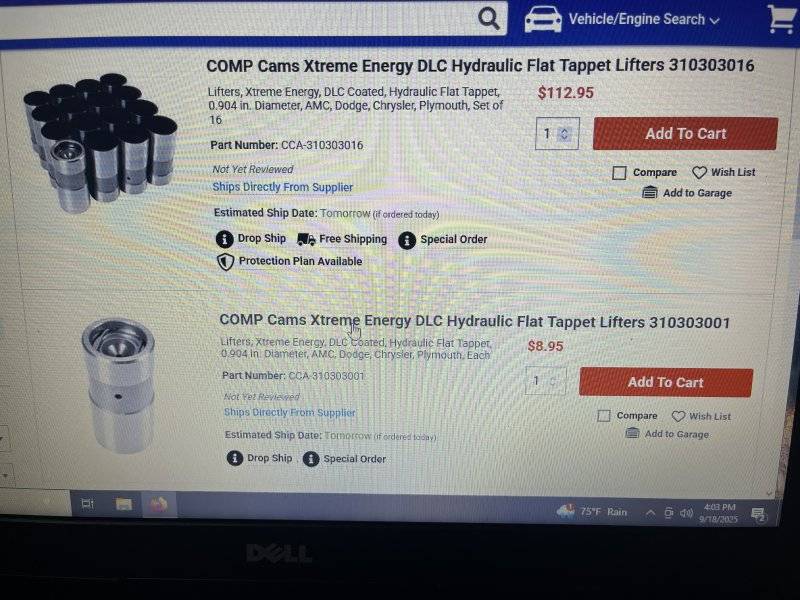

Hey Guess What !
Summits Got Mopar Lifters For Sale
With The DLC ( Diamond Like Coating )
On The face !
I think that’s going to be beneficial in
Helping minimize cam wipe outs , of course when used with proper lubricants!
Gett Summmmm !!
Mopar2ya!
John
I wonder how many people will have the wait and see opinion?
It is funny to me to state this but besides a high failure rate, flat tappet lifters have advantages over roller lifters.
Yeah, besides heart failure and psychosis, methamphetamine has some benefits too.
I would have stayed with a flat tappet setup if I had confidence that it wouldn’t fail.
It isn’t just the inconvenience of replacing a cam, it is the hassle of pulling the engine out and apart to clean out the shrapnel.

Well you didn’t wait to chime innnnnn….
I saw those last year at SEMA. Reminded me of the Shubeck units that were around many years ago. Great idea. Wonder how well they last against their cams.
Didn't the Shubeck ones have a problem with the ceramic face flaking off ?
I read that the Shubecks needed closer valve lash settings to avoid that.
They sure would have been a magic bullet for this failure issue.

Great Question!!
I’m inclined to believe the manufacturers….
Probably were weary of the reported metallurgical failures & proactively sought to improve the product line . IMO .
Hence DLC … if I Was In The Market For Lifters I Would Buy These !

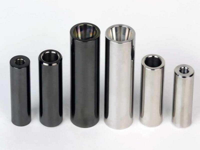

Not Familiar With “ Diamond like coating “
Do your own research & you’ll probably like it too !

DLC is used on many items. But...going to be watching/listening for feedback. In the meantime, use the best lubricant you can get. The wagon will be getting Amsoil when I get the new bullet together. Right now since it has an appetite, $5 qt oil is what I feed it, VR1, as opposed to $12 qt Amsoil.
If the lifter is not machined correctly I am not sure the coating will make much difference - they will most likely still fail.
Even if they don't wipe out the lobe, the modern one's leak down very fast, noisy, and no coating on earth will fix that.
The quality control is rubbish when they are made.
If OE manufacturers still fitted them that would be OK but they don't is the long and short of it.
