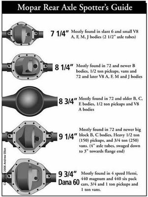

I have a sure-grip differential, 4.10, that I need some identification help with; the only outside case number is 1141544-16. Does anyone know what year(s) this corresponds with?

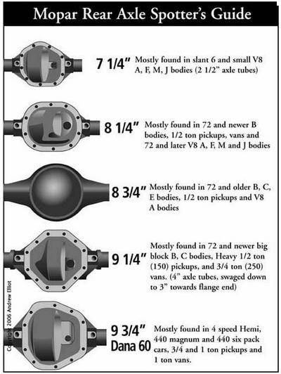

Can't help you with the numbers but this will give you an idea of what you have.
