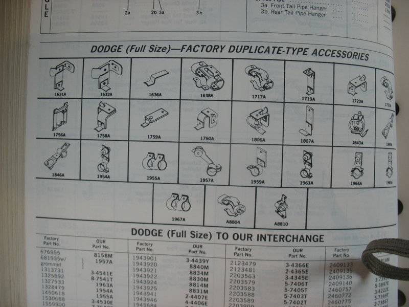

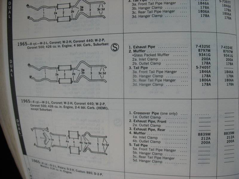

Jan, 1976 Catalog # 800
Diagrams and factory part #'s
Correct hangers also.
Awesome! Would look good in my collection. Nice piece of Mopar history

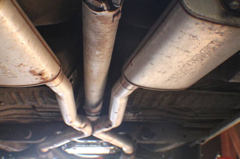

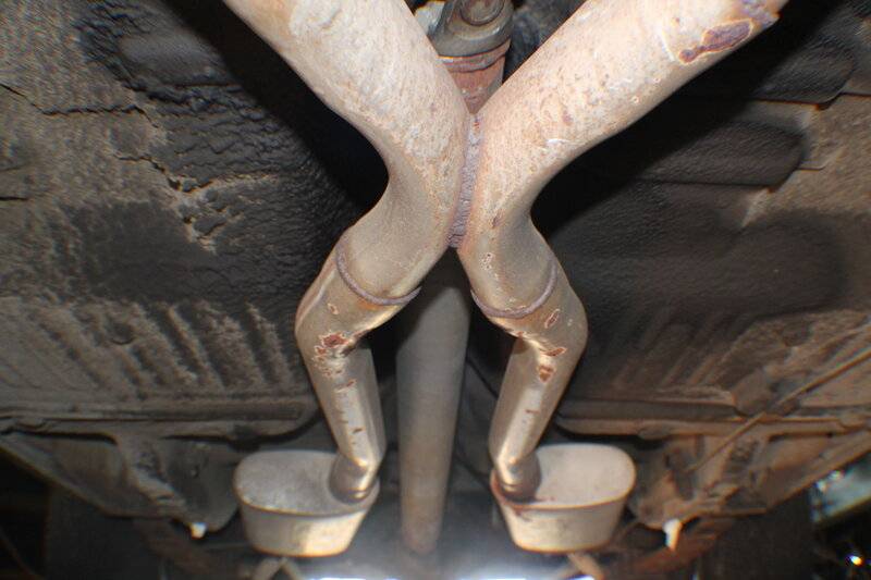

My 69 Sport Satellite SW is in need of a new exhaust system. Guess I'll reference my own book.
I'll have to go somewhat custom, I like what is currently on it. 440 BB and Headers X center to Magnaflows and exiting at the corners of the rear bumper. Open for Any suggestions?

Yes, if it worked, do it again, the same way.

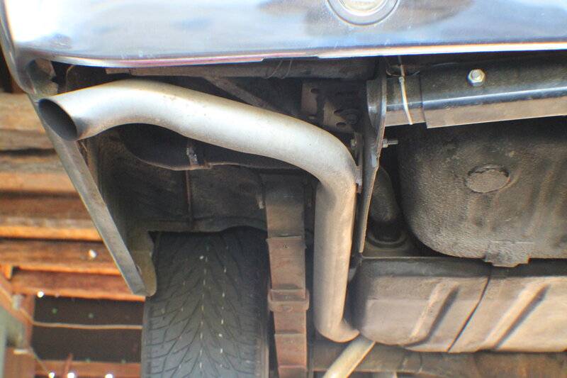

I have not found the same tail pipes. All the ones I see go straight back where as these go out the corners.
It looks good to me coming out the corners. All the cars I have built or owned have had custom exhaust made to flow where I liked them too. I know many will find fault in my opinion, but, it just my opinion.

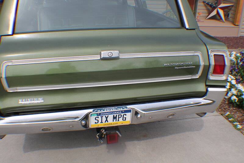

Okay. So, I love that license plate!
You've got a cool setup now, that not a lot of people have..as far as suggestions I've come to prefer the H-pipe, but that's just me. Yeah you'd have to fab those corner exit pipes, which again I think look super cool on your wagon...I would cut them off and re-use them if they're not rotting.
Pictures........................I think I might be able to use band clamps and muffler sealant. For a temp fix.
So decision made, going all new from the collectors back and saving most of the custom out the sides tail pipes.
I'll cut the tail pipes and use band clamps to tie in the over the axel.
Not going SS, any suggestions where to buy?
Update; went with Magnaflow ....................SS MF19303.
